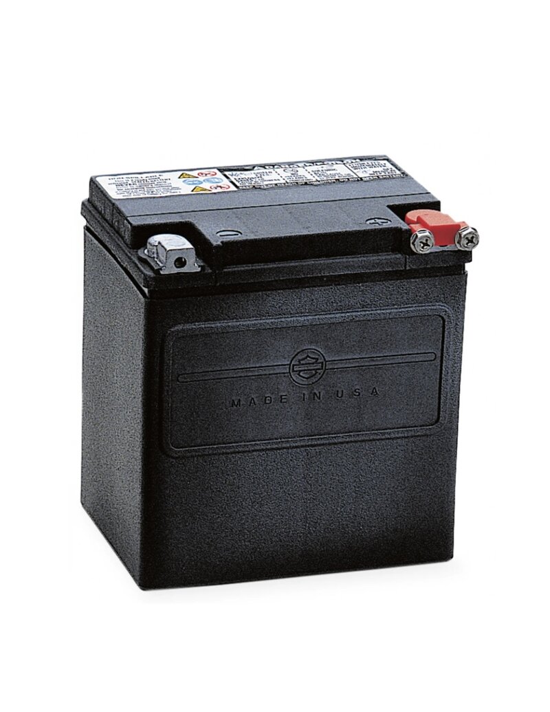

Got all dressed up this morning for a great ride on a beautiful day … turn signals flashing and a horrible sound like screeching metal when I push the start button, fob has new battery. Help please is always appreciated
Don’t have an audible alarm on the Trike … just electronics disconnect … the screeching starter ish kinda sound … pretty loud. Scared me at first
Sounds like a starter drive to me, most of the time when they go bad, they will Screech. Is the battery good ? How old is it ?
Luckily :mad: the battery was dead. We got the Trike about a year and a half ago with what I think is the original HD battery. Put in a new one and was hesitant to push start because the noise was wicked ... started right up, everything nice again. Sorta kinda glad to put in a new one with a new "use by" date :)
If you got 6+ years out of the stock battery you did pretty good. Glad it didn't happen on the road for you.

As batteries age they have a tendency to lose flakes off their plates that sink to the bottom of their respective cells. When a plate has lost enough flakes the new flake falling off will short out between the positive and negative plates and that cell 'dies' so you no longer have a stout 14+ volts feeding the starter. That's why the battery was "good" one one start but not the next.
