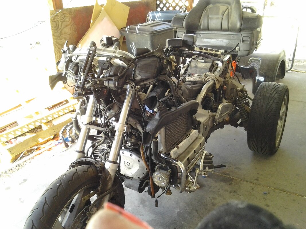

I need to finish plastic welding the right side injector cover. then install the radiator and main stay, then the wiring and she is ready for skin.
yes I'm going to work on this today.
I still need freeze, oil, battery and registration.
she could be finished and still not run need fluids and have zero money and will take months to raise enough.:gah:
when finished she will be all fresh and ready to go new everything:clapping:when she is finished
big progress sort of
ok the main stay is on, the left side is complete, the radiators are on, the wiring is connected. they sent me a left driving light marked right side, it's wire is short other wise it fits fine except were it says top on the lens is down. I will extend the wire and no more issue.

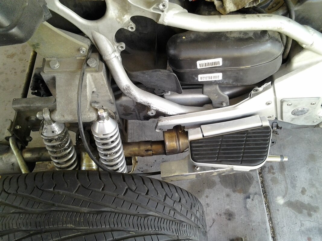

I purchased a 2001 right side exhaust and the out pipe at the end points out more so we modified the connecting part from dft to move the exhaust back into place.
other than fluids she only needs her brakes done and we will do the front tomorrow.

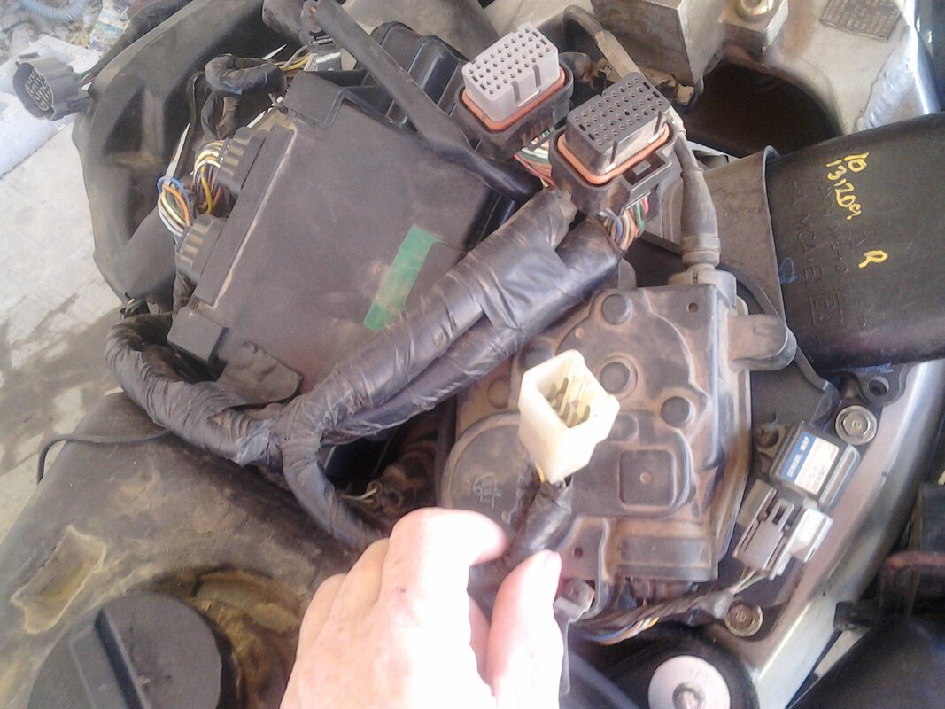

there is 1 main harness plug that is unaccounted for going to test the balance module
my money is on the unaccounted for plug, every thing else seems ok she turns over nice. it is a 13 pin square connect on the same part of the harness as the radio plugs I believe it to be a connect to maybe the coils or something that fell under the tank as we can find nothing to connect it to.
yea not bad luck just finally at a point of testing the electrical system.
no damaged parts no missing or bad grounds all connections made except for 1 square connector on the main harness with the 2 radio connectors it has 13 pins. all fuses good all relays good checked everything else
we believe it to be the connector plug for the coils. we believe the other connector was left under the air box by mistake.

Not sure by the pic. the exact plug you are holding but there is connector very similiar to that one that is for the cb.

Not sure by the pic. the exact plug you are holding but there is connector very similiar to that one that is for the cb. I would be checking the bank angle sensor first. Since you have had the entire fairing off, it could have been easily overlooked.

the cb connection is under the trunk
Not sure by the pic. the exact plug you are holding but there is connector very similiar to that one that is for the cb. I would be checking the bank angle sensor first. Since you have had the entire fairing off, it could have been easily overlooked.[/QUOTE]
Rowdy after installing my CB I have to agree with you on the plug. Triwingirl have you checked out the sidestand switch? Im just fishing here so bear with me.
let me emphasize again everything else is ok INCLUDING THE BANK ANGLE SENSOR
Well since you seem to know all about it I fail to see why you post here for suggestions. By the way, you need to look into the cb installation farther. There is a white connector for the cb under the shelter. Whether or not the one you show is it I do not know. Good luck with the repairs.
Heres a pic of the CB plug connected on my bike. You can follow the line taped to the right side of the tank to the plug I have circled.
ok ill tast the bank angle sensor for damage it was connected. I don't remember having a loose plug I thought they were all used. I do not have a cb. the f-1 light does not come on and have checked the relays and fuses. no damage to harness everything else works. no reason to suspect computer. may have bad coil as wires were torn and may have shorted. bank angle sensor did take hit.

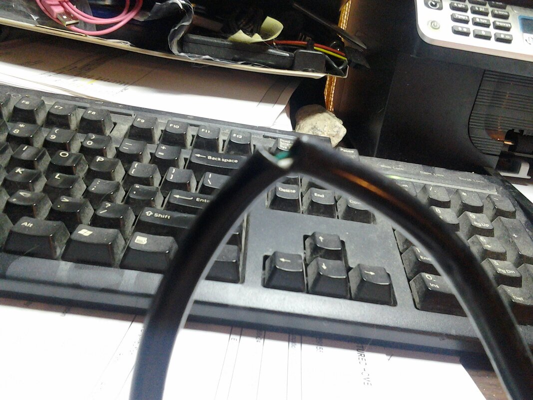

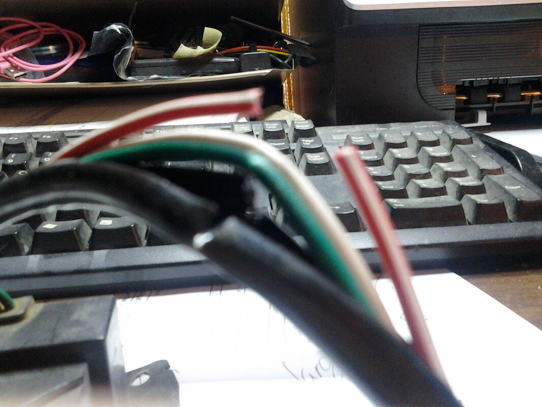

OK I FOUND SOMETHING:blush:
I removed the bank angle sensor and found something.:blush::xzqxz:
I MIGHT BE WRONG BUT I THINK THIS PART MIGHT NOT BE TOTALLY FUNTIONAL?
yes it's the bank angle sensor :gah::gah::gah:

some good news we installed the repaired bank angle sensor and turned the key the f-1 light came on.

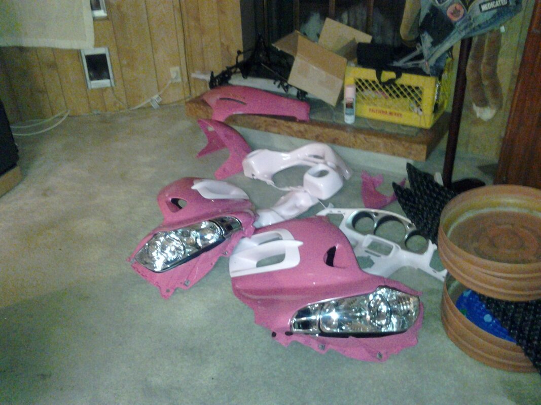

took her for ride up street and back has good acceleration,steers good drives straight brakes work great. cant skin her until engine idles down right.

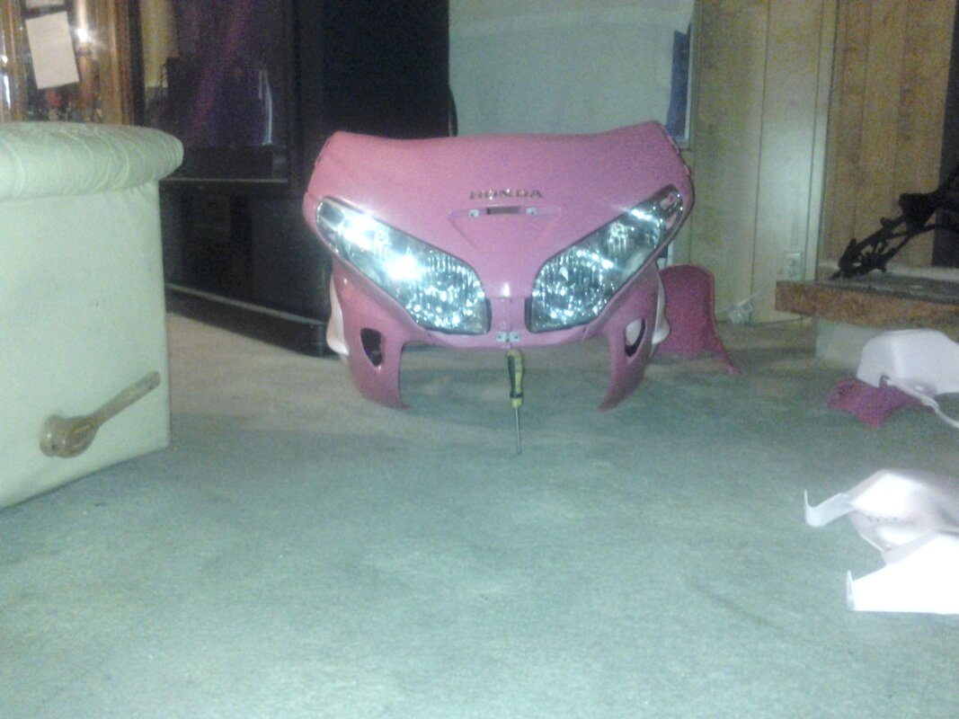

her skin is assembled and ready to go on. a very unique combination of light and dark pink and black. some parts just needed to stay black and others I ran out of paint so sue me.
