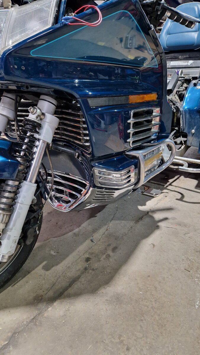

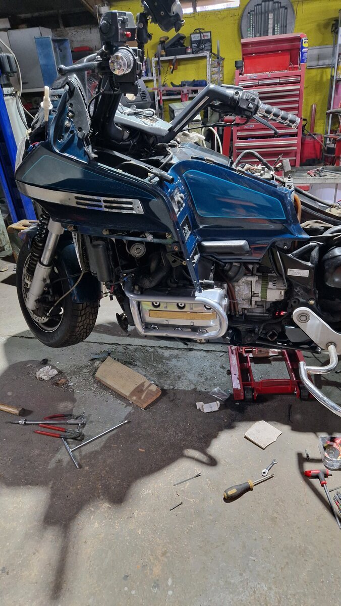

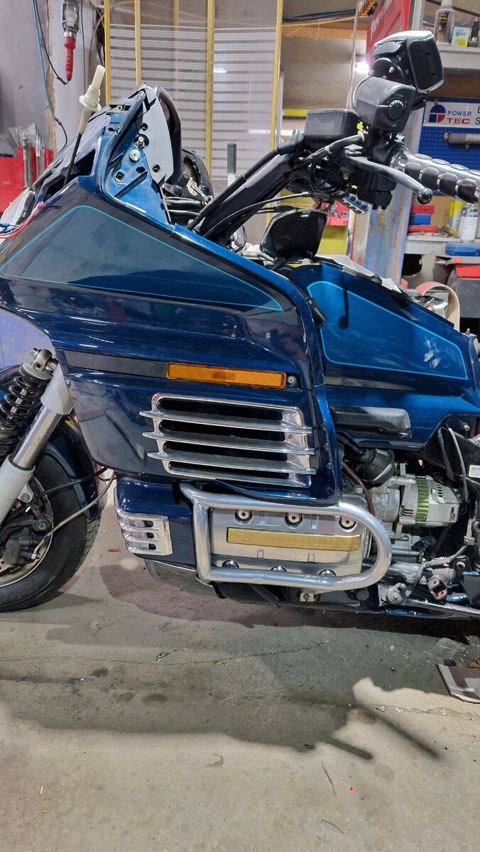

The slow process begins
Bought the trike ready converted
Was originally done by Appleyards

Take time when removing plastics and note that many parts are held by different length screws for a reason.
Some have shaped heads to retain other push on covers.
Careful if removing grille below headlight, small screws often broken by previous amateurs
