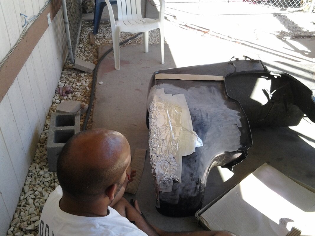

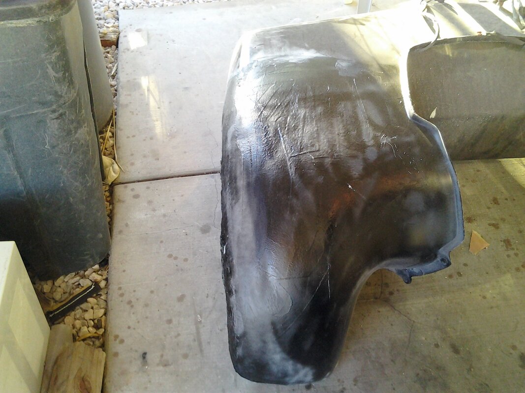

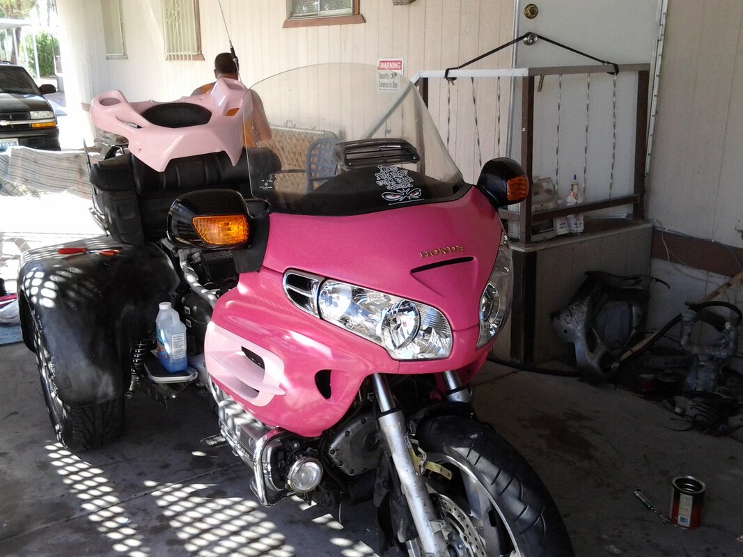

well I fixed the rear fenders, it cost me a couple hundred and its a bondo job. started with aluminum tape form then bondo, the fiberglass bondo. it on both sides and seems solid.
YES I KNOW ITS A BONO JOB AND WILL CRACK AND BREAK.
IT WHAT YU GET FOR CHEAP.
they are solid and whole.

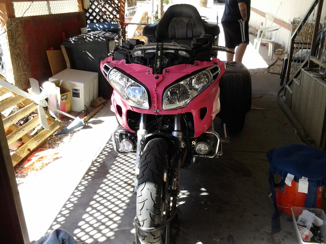

I got the new cowl stay yesterday while installing the speedometer I broke off one of the bolt supports and had to glue it. the glue dried and I installed it and the stay on the trike , reinstalled the electrical and vents. got everything ready for the lower cowl and fit in on, im now getting the clips in order to put on the windshield. JOY now has rear fenders again.

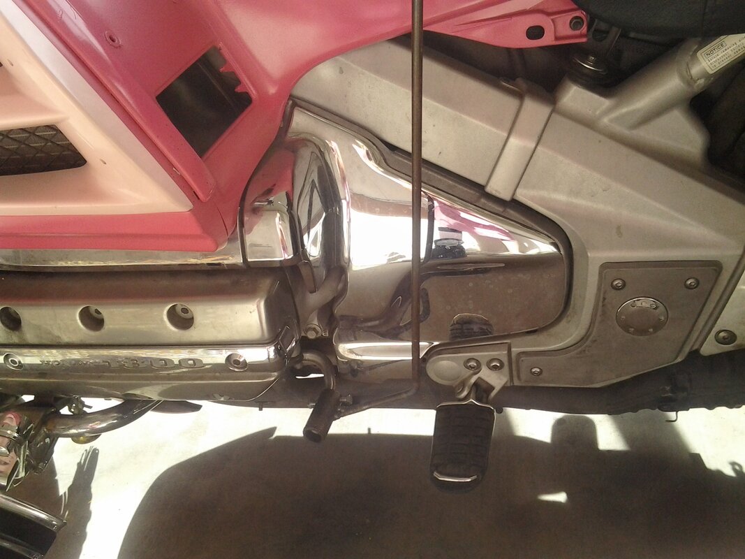

I am designing a suicide shifter that I can use to ride with, cant ride if cant shift. :confused:
it will come up the left side and cross over the tank so I can use my right hand to shift. it should be sort of push pull as apposed to up down , from the angle at which it will move with the shifter.
so im going to have a pink goldwing trike with a suicide shifter on it.:cool:
never give up never surrender ride no matter what it takes ride or die.:laugh:

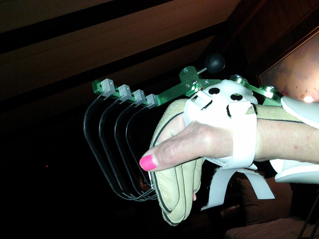

oh yea I got my finger stretcher, I mean my self torture device. medieval looking huh.
well other wise im ok and I will not be stranded anymore 8 months was enough. :kpzxvq:
yea and I got a paddle on my throttle so not to much of an issue and I can almost grip the throttle with 3 of my fingers.
ThumbUp
this is my first attempt it was made by my friends dave and I thank him very much.
It does not pivit on the shifter it is solid and does not move. so it shifts forward and back and has just enough room to do it.
I have not riden it yet but don't expect an issue.
I will make first trip to home depot for parts. I got an idea watching dave fit this it was loose and pivoted and moved up down. so I need something that pivots.
I have cup holder screw connectors on my cowl. so I get an eye bolt that will fit around the shifter and use say u bolt clamps on both sides. now I have a pivot. put another eye bolt in cowl screw hole. stick rod through eye bolt and connect or weld to eye bolt on shifter. now I have a up down cowl mounted shifter and add a cool knob and there you go.
