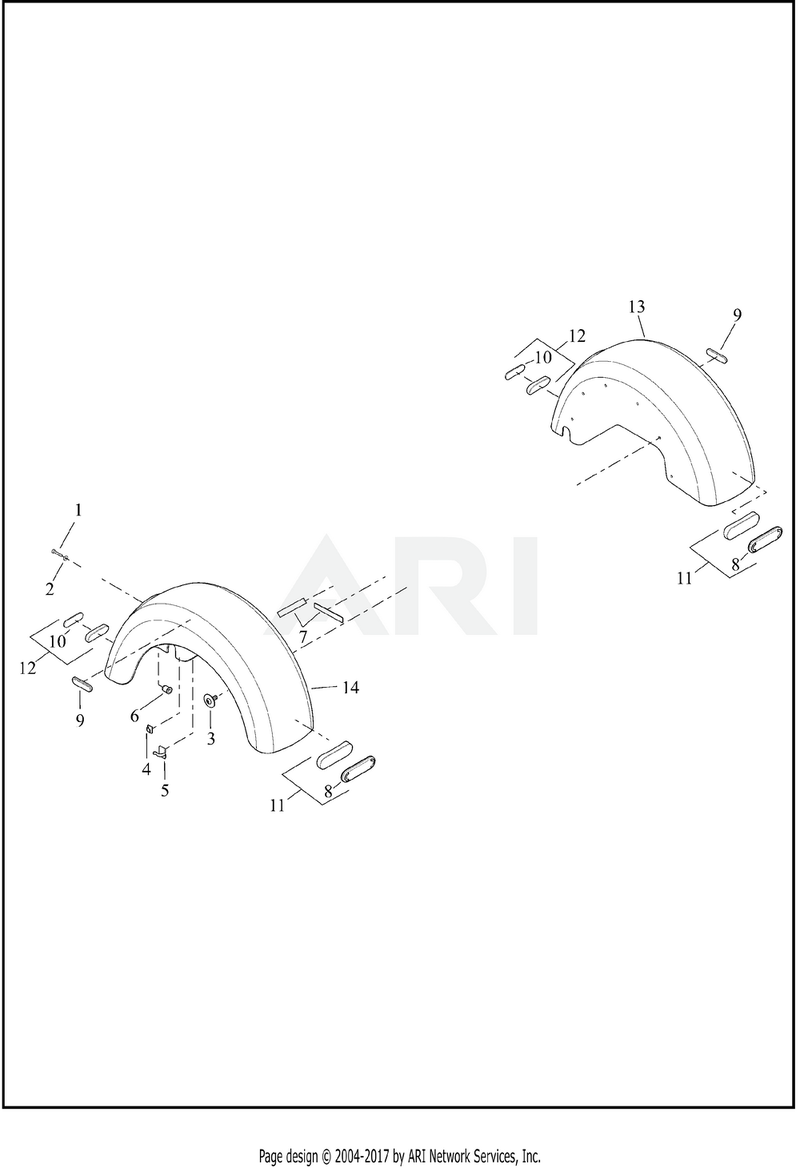

Jerry, this is a 2020 model, I cannot find the 21 or 22 yet
What I see is I bet the nuts the screws attach to are caged and that may be why they do not tighten up
Have a look @ the picture here, I bet #7 is the piece that houses the nut
68296-99A

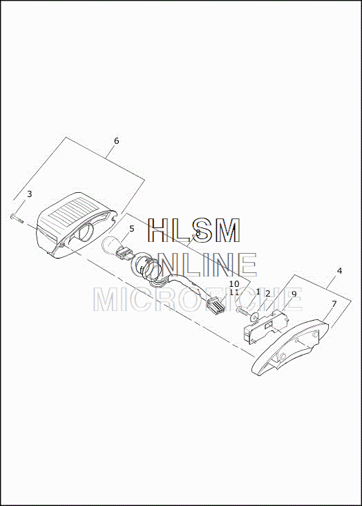

Part#6 in the diagram below
PN: 83778-11
INSERT-TOP HAT,PRESS IN,1/4-201
68296-99A
part number
Part
68296-99A
PN: 83778-11

Thanks Kool, for the listing. Make a lot of sense looking at the diagram of the part. Thanks
The lens is fastened with its own two screws, the bolt through the fender only fastens the backing plate....at least, that's how my 2020 is....I hope this helps....DW
