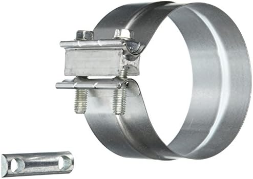

You can do whatever you like your bike but I would not weld the mufflers, just me, if you ever want to change out mufflers it will be more harder to change out mufflers, just drill a hole and tap it and add a stainless bolt or use the automotive type clamp, just me I guess, personally I can't believe harley is saying to weld mufflers, that is not right.
All for now Trampas
All for now Trampas
Agree 100% ..I would NEVER weld. Automotive clamp .or screw,like,others have said. Luck whatever you decide. Keep in mind ,there may come a time you have to remove,& welded, what a mess to get off. :confused:
If you allow the dealer to weld on your exhaust, consider having them lay a piece of 1/4” round bar across the joint and weld each end. Just like the screw, one piece will hold it and it should be easy to remove with a hacksaw or grinder.
Using an automotive clamp may give you a pretty good fight to remove the muffler later on especially if the clamp is over tightened. Good luck with it.
Sounds like the gasket, deteriates, causing the gap, then its loose? Springs under heads of bolts, so the spring keeps some pressure on the joint. Most turbo clamps, and wave springs in other applications, keep the required tension.
I do love band clamps. My favorite
High temp from a gasket smeared all over the pipe just before sliding it in and clamping with a new clamp solved that problem for me. About 20 k on it and still holding
