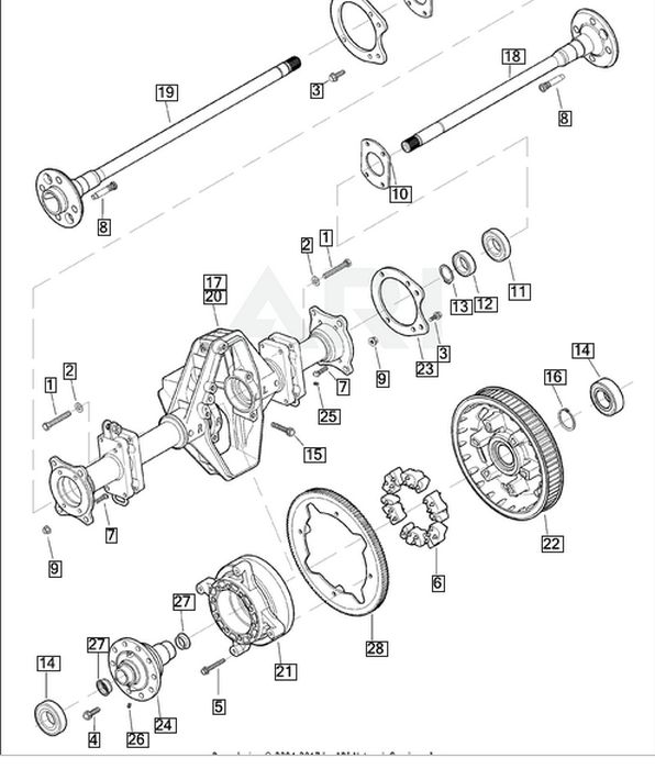

As rhino said, it could be the isolators. Below is a photo. The bottom row of components are all in the housing.
The clip (#16) is a known failure point. The bearings are pressed in (#14) and could have shifted.
As you can see there are a limited number of parts in there, so should be fairly easy to track down.
We have seen it before, where the axle bearing retainer plates bowed too much, allowing the axles to move too much on the spline end, resulting in the bearings shifting/clip failing. See photos of the ABRP's at this LINK.
