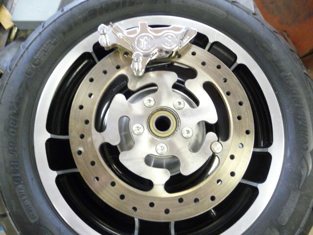

I changed my mind on using the 18 x3.5 wheel (i'll use this on my side car rig with avon trike tire!!)could not live with the way it looked - too narrow for the size of the trike so picked up a 16x5 harley rear wheel and 180 x65 x16 tire looks right for this trike better proportion's in my opinion
1. this shows the drive side of wheel I milled 1/2 inch off this side and made a hub cap.
2.just shows the rotor and caliper side of wheel.

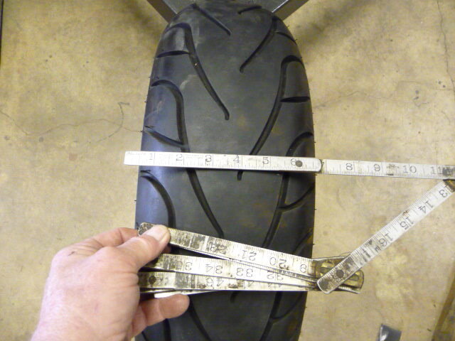

3. this was to show the wheel is aprox 8 and1/4 inch wide with the 1/2 inch trim job,,, but if you can see it your doing better than me!!:xzqxz:

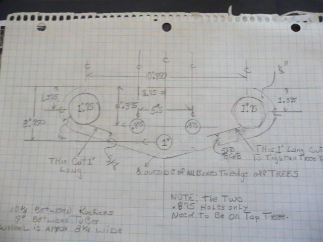

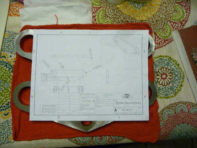

4. this is a copy of my upper tree drawing- lower tree won't have the two .875 holes for rubber mounted rises and the neck bore will be 1inch and .050 so I don't bugger up bearing mounting area's

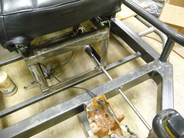

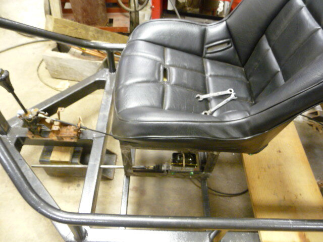

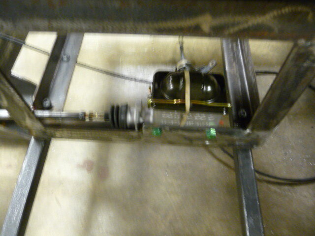

well no news on my triple trees as of yet I hope I would have them by this week end,,, guess I 'm not a high priority @ shop where my son works as I don't want to pay for the work :Dso,,, worked on master cylinder location for rear brakes today, as of now its located under floor level in storage area under drivers seat-think this will work out ok ...started work on pedal assembly as the one I bought is with the 18x3.5 front wheel that I'm not using waiting for new home!!
a few pics of install - nothing to special but its progress!!
magoo
you can see shifter in 1 & 3 pic. as for now it lives up front n center of floor we will see for it wonks out

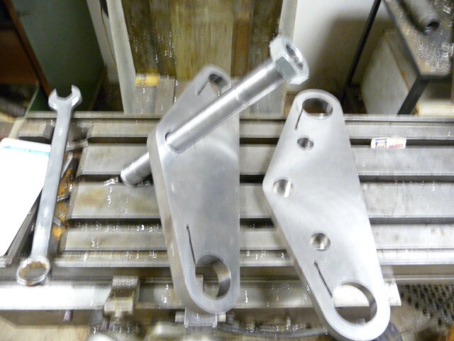

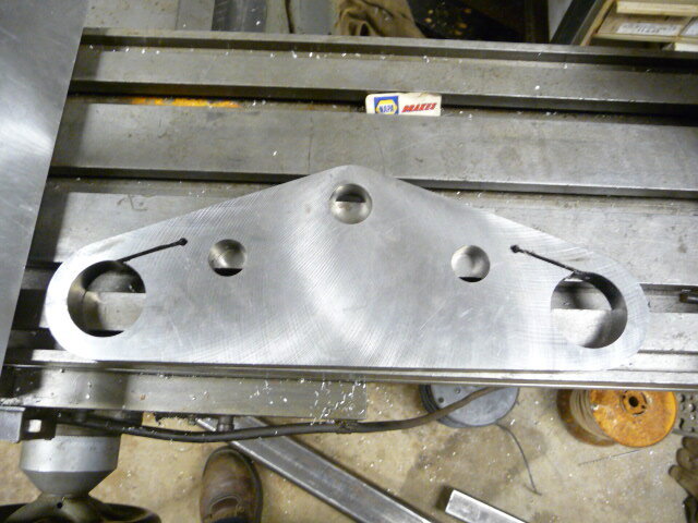

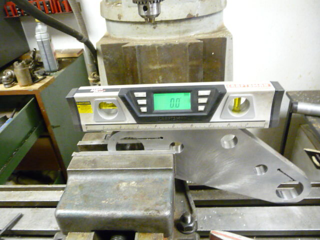

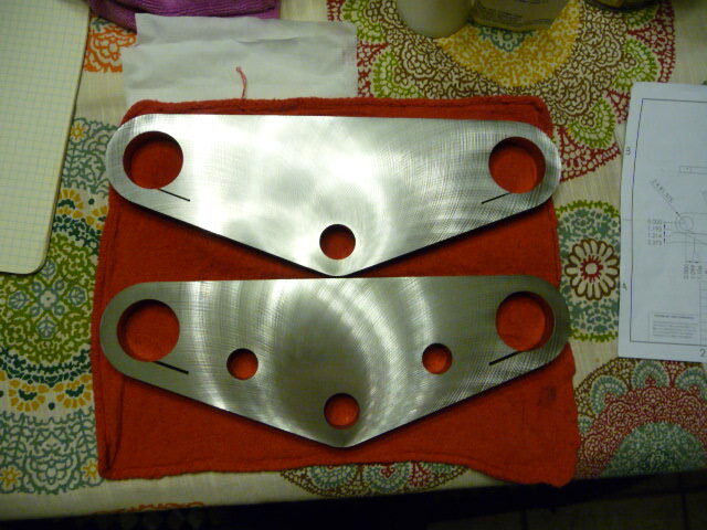

heres a couple of pics went from my hand drawings,
to cad drawing to 3/4 inch steel. now I will make a neck stem , tubes etc. and the trike will be a roller!!
magoo

not sure but you may want to lengthen the slot a tad...

my son did the cad drawings and cut them on water jet at the shop he works at-then hit the flat sides with surface grinder & chased the bores on Bridgeport as with 3/4 inch steel the bores are flared a little on outlet side of cut...with water jet, so bores are cut a little small and trued up.

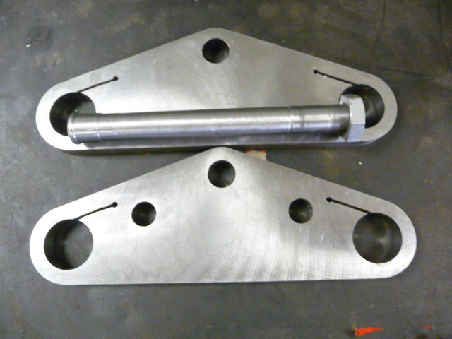

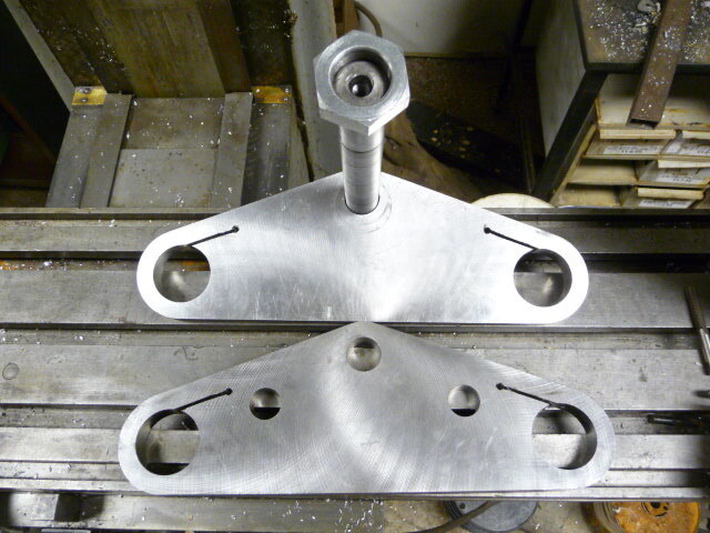

finishing up on trees!!
well I didn't think this would be much of a job to build trees,,, but it sure has been a time bandit !!
ok I set the stem up 1.5 thousands over for the press into lower tree after starting the press I took it out and went to .001 much better!
here is a few pics.
1-3. this shows all 3 pcs. and the relief cut-I did add 1/2 inch more to cuts and 3/16 hole @ end of cut just cause I thought it would make things work easier..
4. I was setting up for holes for pinch bolts, I will use 3/8 allen bolts
5. just shows pinch bolt holes 3/8 on out side ,, 5/16 after relief cut for tapping.
6.well there they lay waiting for dust covers that should have been here so I can assemble on them on trike and carry on with build. I am considering using ss steel tube for front end any thoughts?
