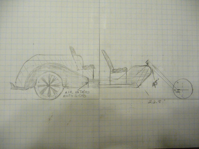

ok I been at a impass for about 3 days.. the trike has 12&1/2 ft. wheel base as it sets. I wanted under 10 ft but can,t get there as its going..

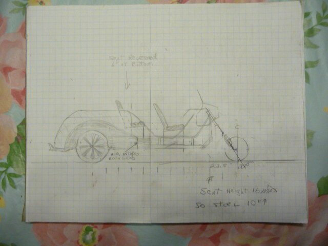

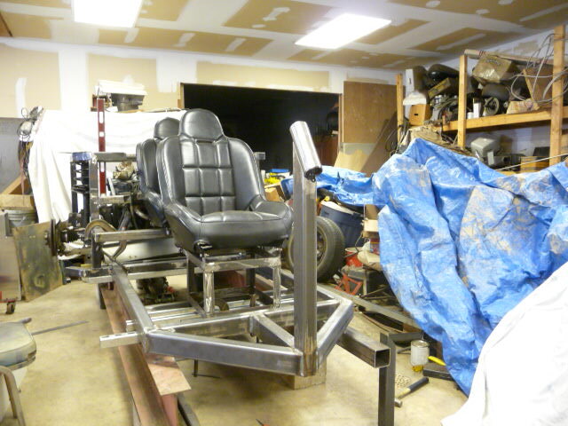

I redrew trike moved steering head back some and changed angle to around 32 degree, moved passenger seat back as far as possible with things as they are .. see photo 1. wheel base is about 11 ft. now still seems long to me drawing 2. is my first drawing 12.5 ft.. I know the drawing's are ruff but hope you can see the difference in the 2. also 2 squares = 1 ft.
so wife says consider seats side by side...ok that's a thought should knock off 3 ft. but I can forget about using a bike windshield!!
could move rad to rear frees up 6 inch but a lot of changes to do it
can also probably tighten up our leg room some...
any thought out there??
I'm I missing the obvious?
I think a little move rake on front end looks better...I think both will handle good- I just like longer front ends.. through back from the late 60,s I guess!!
or is the long wheel base no big deal?
I was hoping be able to make tight turn you know...
hmmmmm got to do something so what say you?

On most motorcycles legs of passenger are right next to rider. ( almost overlap ) you don't need knee room or foot room for pass. There is nothing on the side of you..
hi john
I know that's how bike is.. but though since my design has perimeter frame and flat floor, why not more leg room for passenger?? but you bring up a good point I could make my seat base narrower say 10 inch wider and just have 1 inch tubing on top extend out each side to seat mounts, I think they are 14&1/4 wide center to center... and then my seat back some,, wife won't complain. hey its getting shorter as we go!! thanks for the input john..
magoo
I personal think legs stretched out for a pass is more comfortable than sitting in a chair with feet in front. More stable too.
yes I agree with you both...
my thinking was the room in front of passenger seat would make it easier to get seated(no need to hike leg up and over seat).. would think that passenger would stretch out, use foot pegs or what ever once seated...
in my case I'm not sure how wife knees will be down the road...
what I know for sure is that spacing is shrinking as we talk:)
magoo
As I see it the length of the trike really doesn't matter. Mine is approximately 16 feet long from end to end and it still whips a u turn on a two lane road without a problem. And think about it, when the wife is happy, the driver is happy too. I first had my vw trike at about 11 feet long when I first got done but soon found to be popping wheelieswithout even trying. In the end I ended up extending the length to it's current size. I also built a leading link front end and done away with the motorcycle front end. Now everyone is happy.

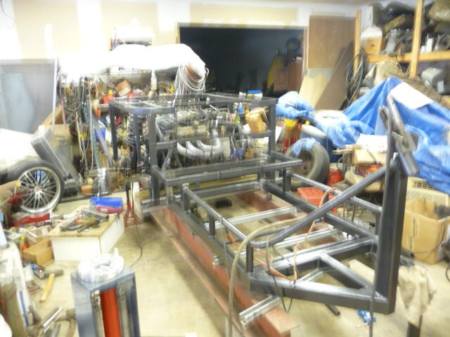

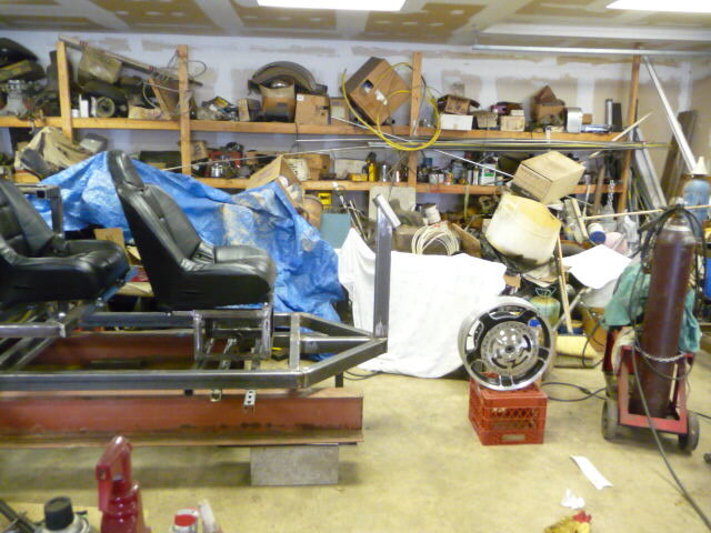

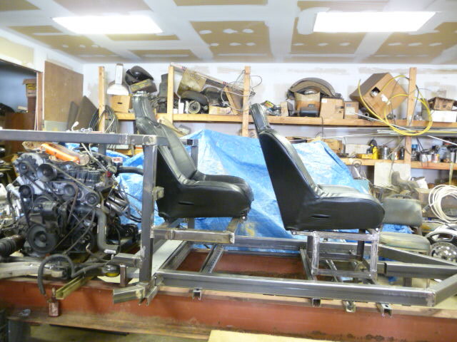

1. in this shot you can kind of see the steering head location ...
its kicked out at 22.5 degrees this will be changed to straight up and down, this will move steering head about 12 inches closer to me...about the same as my hd. and shorten wheel base too!!

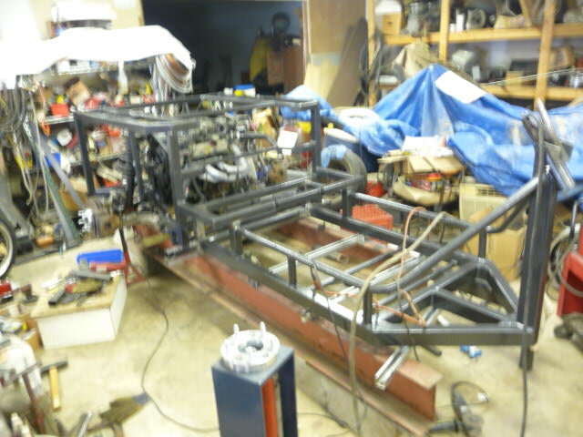

2. this shot shows spacing... 4-1/2 inch between seats( any closer and its not comfortable seats are wide!) .. drivers seat is 4 inch lower.
so this is starting to move forward at last!! I need to weld up the lower frame then I think I will get it off jig put tires on rear put a jack stand up front and draw up front end...oh yea !! that's what I been wait'n for!!
magoo

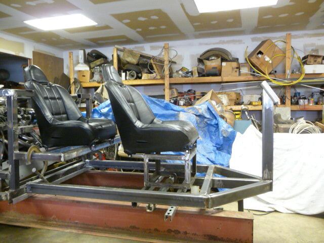

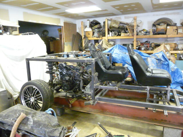

1. shows the new location of steering head and moved front seat inch forward.
2. engine area rear wheel/tire(18x8wheels-225/40r18tires) and seating with the extra inch between seats I can get my feet through there!! so all is well.
3. approximant location of front wheel.
4. just a different angle of front.
will be doing more welding and tube bending this week,, waiting on new liner for my larger mig welder to much setting in non-heated area last winter I guess old liner is corroded.
any way I'm going to try and finish up the frame in a week or two depenfing on when I get welder going I can tack up with my smaller welder sp175 but only have .026 wire in it...would prefer using larger wire and that's in the larger welder.... there is plenty to do !!!
more later magoo

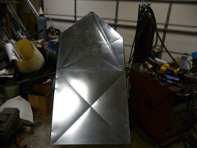

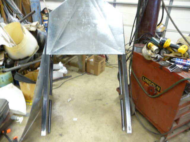

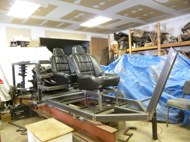

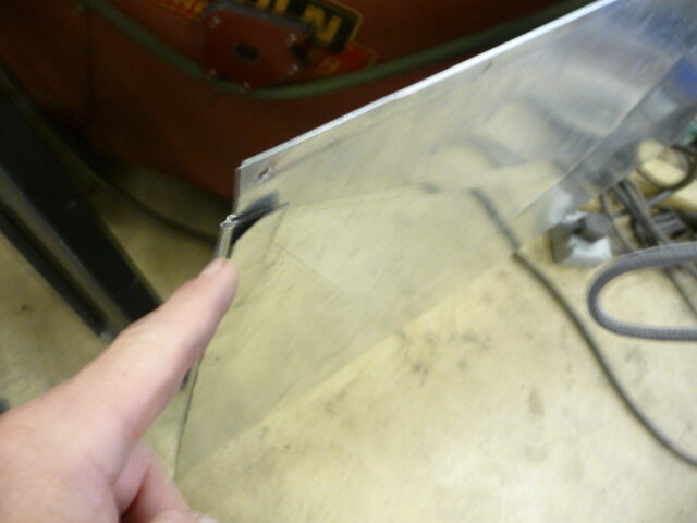

ok while I had front end of frame off to weld I bent up belly pans
1. shows pans on frame
2.just shows front pc. and
3. this shows weather lap folded up on each pc.
4.&5. shows frame welded up for keeps!!
tomorrow if the stars are in my favor i'll bend up running board and install them..
