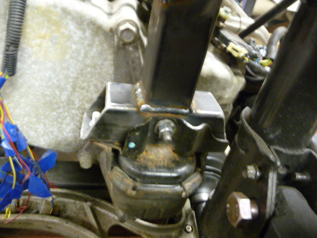

so... off to the shop I went,, the motor mounts are about finished
1. right side mount.. needed to be removable to change belts..
2. another angle of mount I think you can see how tight it is and it needed to be offset some to clear everything ..I will add a piece of tubing to tie in at top like you will see on other side
3. left side mount this end is attached to motor mount and mount is attached to chain housing..
4. you can see it needed to be offset to miss spring/strut that I moved in 2.5 inch...
5. you can see that I make this mount removable also that way if I need to jack up other side to change belts I will have a little more side motion...the engine/trans are fully isolated on all 4 sides at last!
slow going but moving forward!!
magoo
