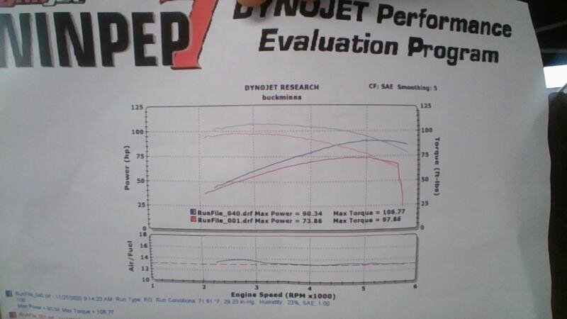

I have Jim Palmer extended warranty and it allows aftermarket parts. I did the S&S 465 cam, S&S premium lifters, newest HD oil pump, Fullsac Sportpipe head pipe and a TTS tuner, already had Screaming Eagle Street Cannon mufflers. The tech at the shop said he hadn't used a 465 cam yet so he was all in for using it. After a full dyno tune the tech said he was very impressed with this cam, said he hadnt seen that much low rpm torque from a cam change. It has 100 ft lb of torque at 2300 rpm and maxes torque at 3000 which is my normal riding range, this thing pulls like a tank from off idle and pulls me and the wife along with our trailer with no problem at all.

The one thing to remember is the trikes will make about ten hp and ten ft lbs less than a 2 wheeler with the same components due to parasitic drag of the 2 rear wheels.
