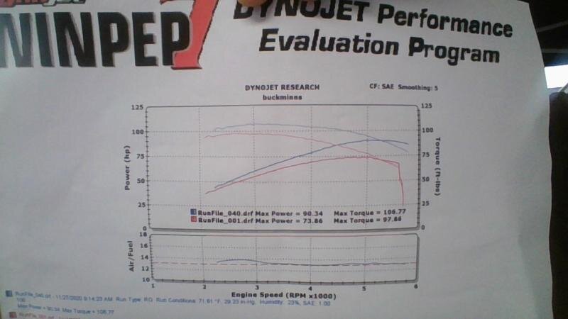

I did the same with my 2017, S&S 465 cam, Fulsac head pipe, S&S lifters and a TTS tuner with a full dyno tune. It now runs great and has a ton of low end torque.
