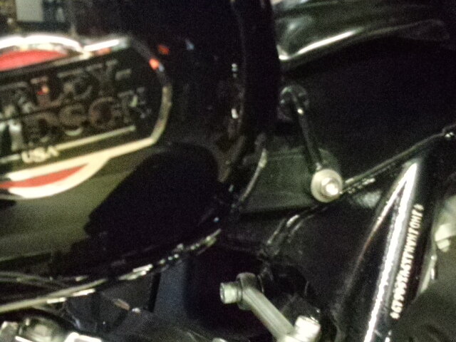

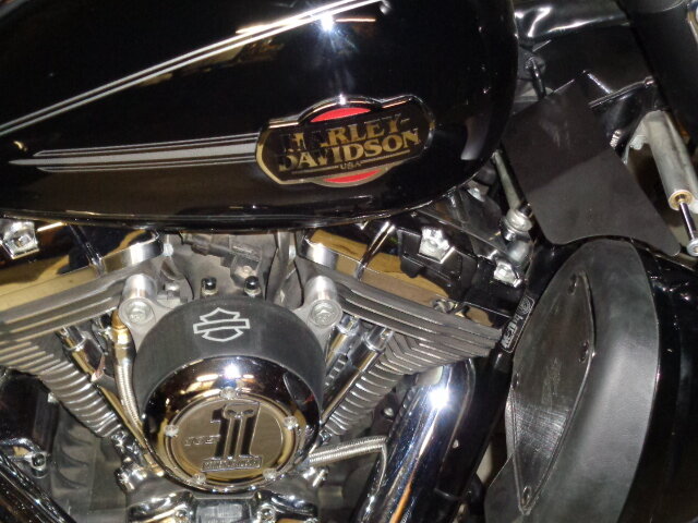

Don't forget the tank lift ThumbUp got mine ordered, group here highly recommend for alleviation of engine heat on the Freewheeler!

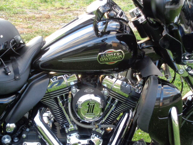

My old 09 sure liked the tank lift more air on motor less in face, you can tell by the number of bugs on tanks and their location on it. :D Ride safely fred
Tank lift is a good I seeing I will be ordering from D K Custom
