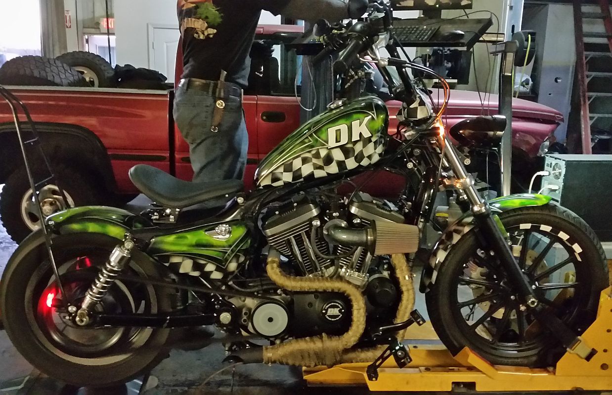

Here are a few pics & videos-
We also had a Street Glide, but I completely forgot to get any pics or vids of it.
Click HERE & HERE to see videos of the 48
Click HERE for a video of the DK Sporty

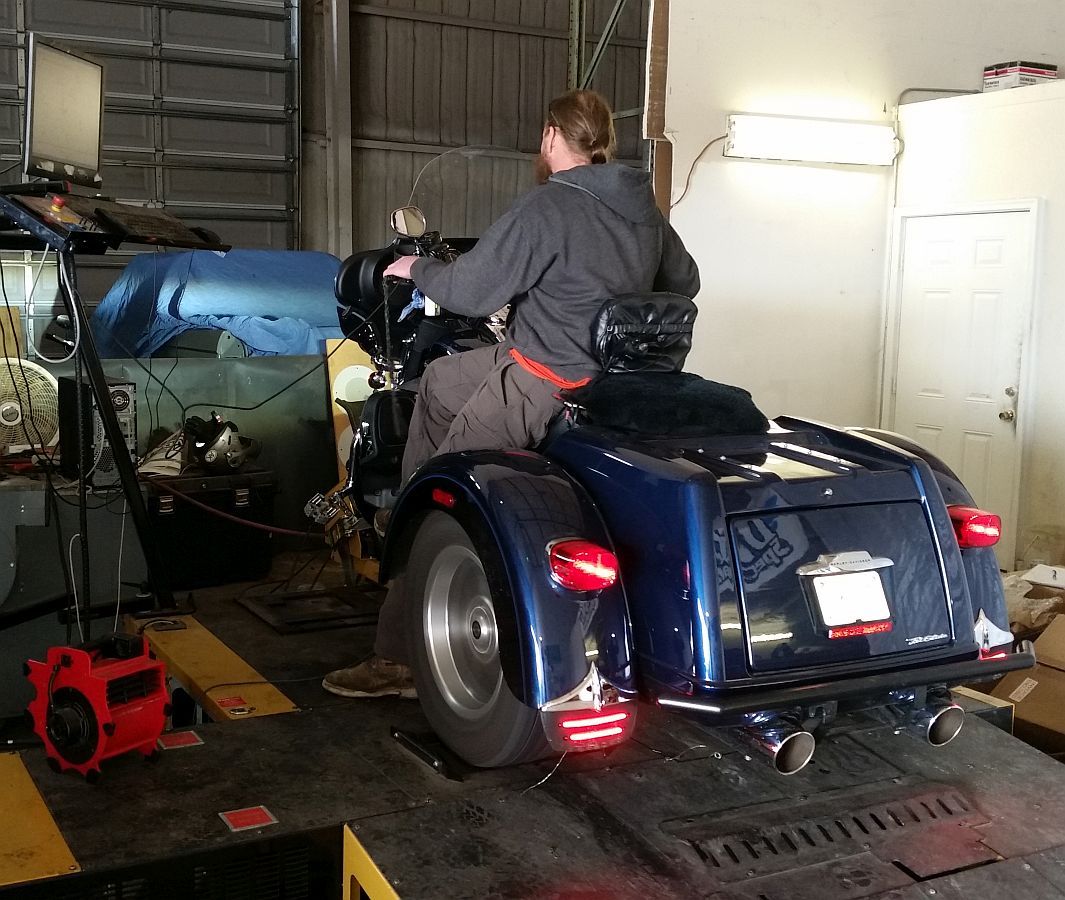

SO, getting back to the Stock "High Flow" air cleaner.
We did this test on my 2014 Tri-Glide.
We started with the stock "Stage I" air cleaner, free flowing slip-ons, and the canned HD Stage I tune. A complete Stage I upgrade (according to HD & others).
We then changed to a DK Outlaw A/C, which is a True Free Flowing Air Cleaner, and we used a canned Stage I tune for it. The exhaust was not touched.
The results were about what we expected. However, it was very nice to know that, in this instance, our butt dyno was accurate. ThumbUp
