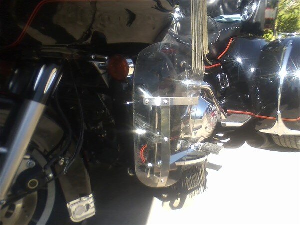

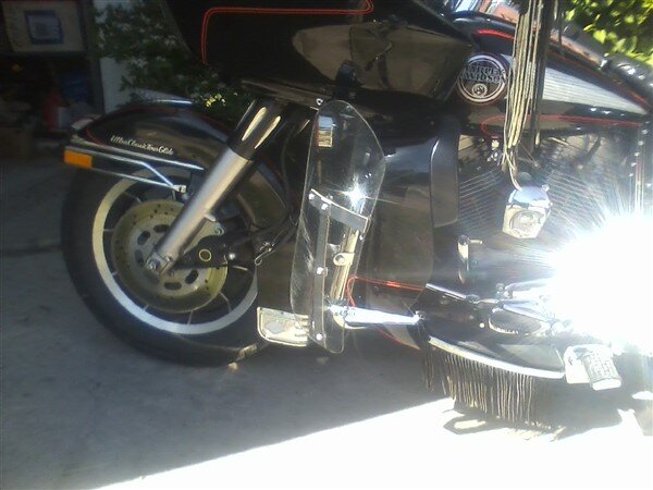

For some time I have been considering making deflector shields to cut wind drag and keep those infernal bugs off my fenders.
Here is what I made in the last few days.
The Plexiglas is heavy duty and concave rather than a flat piece and I made some really professional looking mounting brackets, The plexi could be painted if wanted to but for now I will keep them clear.
Maybe someday I will tell you what I made them out of?:Shrug:
I took it out for a spin and have some adjustment to make to completely throw the wind around my fender and keep the bugs off but I will tell you the immediate difference was felt in wind drag. Kind of like I got another 10 horsepower.
I don't know yet how it will affect gas mileage, The trike was steady at highway and interstate speed and it cut down on wind buffet. A side wind didn't affect me as much as usual, so I'm gonna keep playing with it.
When I got back from my ride I had to wash three bugs off the fender and many more off the shield.

Don't know about the bugs....But they look like they just might keep your knees from freezing in the winter....ThumbUp
It feels rewarding to me when I make/fab something AND it truly works!;)
Hopefully it gives you the same pleasure. :clapping:
I won't give away your "newly fabbed" parts previous configuration/accessory Paul, but I'll say with 99.9% certainty that it was once "one".:Shrug:
I've never tried so I'm not sure how well Lexan covers, but painting on the leeward, (not windward), side might work...?
Your new deflectors look good as is to me, but beauty is in the eye of the beholder...

You may very well have figured it out, and the amazing thing it looks factory made.
You just watch, some one will be selling them before long. I should patent huh?

Looks good Paul! And you are right, they do look factory made. Awesome job! Glad they worked the way you hoped they would!
That is very cool! Nice work, and it looks like a definite plus for cold weather riding.
What has me really interested...even though there is extra wind resistance at your shields, it is reducing the wind resistance at the rear fenders enough to give a significant increase in felt power?
Yes, if I were you I would definitely look into patenting it...if it is possible.
Of course, the Chinese will knock off your patent and there is very little that can be done about it....we know that all to well.
I would say they are cut from windshield and brackets..look good, there was some thought put into those.:clapping:
Bingo, They were cut from a removable windshield, The brackets needed some minor retrofit but all in all it was just a matter of figuring it out.:clapping:

Kevin, im not exaggerating when I talked of wind drag, I even noticed my tach running a might slower than normal at 60 mph.
Your a might wrong about added wind resistance, The Plexiglas is concave rather than flat and the way its tilted creates a slip stream rather than a barricade.
Im going to tip the edge out into the wind a little more to avoid the three bugs I washed off yesterday.
You will notice more bug spatter on the shield closest to barrow ditch.
If a big bug comes in from the side there isn't much you can do about that one except hope it hits the passengers legs? LOL

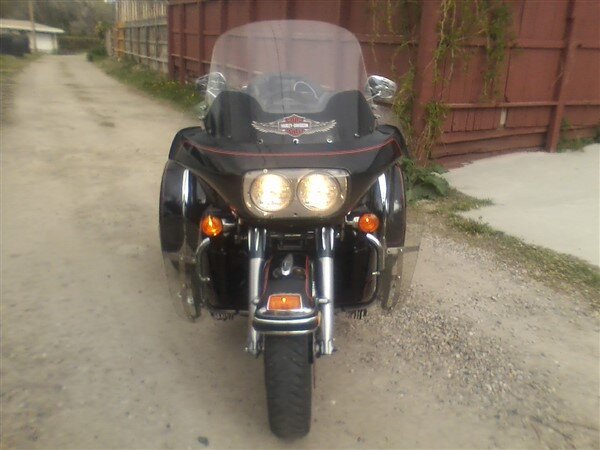

:Coffee: have been tweaking them and doing some adjustment. Here's a picture from the front.
They really don't stand out just looking at them? Took it out for a 50 mile run today.

They do blend in with the frontal view of your trike really well, Paul.ThumbUp
I still they look good "Au~naturel", so to speak! (No paint needed...?)

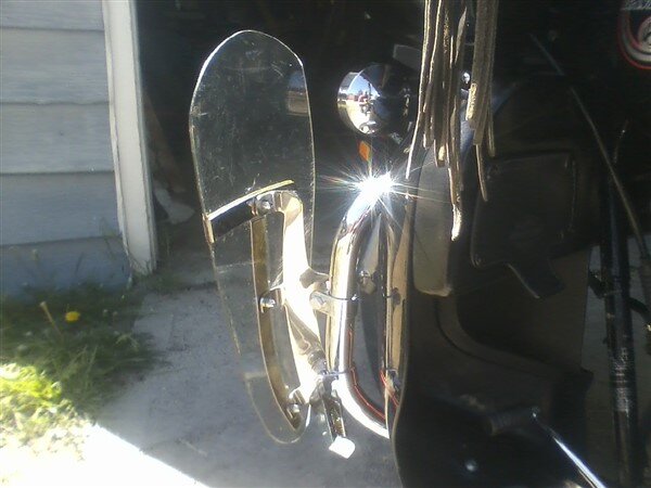

well I tried switching sides and turning the wings upside down and it just didn't work as well as I imagined, so I turned them back around and did some adjustment, Gonna run em that way.
