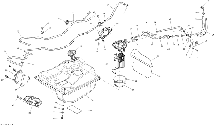

fuel system.pngI have the 14 RT. I just fill and ride as mentioned. Got rid of the Cat.(Cat bypass was installed) But that was my choice to do that.

I attached a picture of the fuel system if you can see it??? #60 is the fuel EPA filter/Breather
Yes, I see #60, impossible to see where the respective vent tubes attach to the fuel tank. By the way, good idea getting rid of the cat converter, in my opinion. I thank you for your patience.
