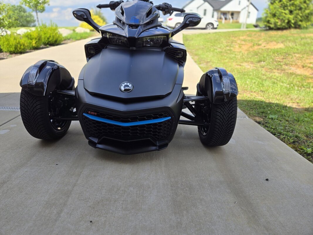

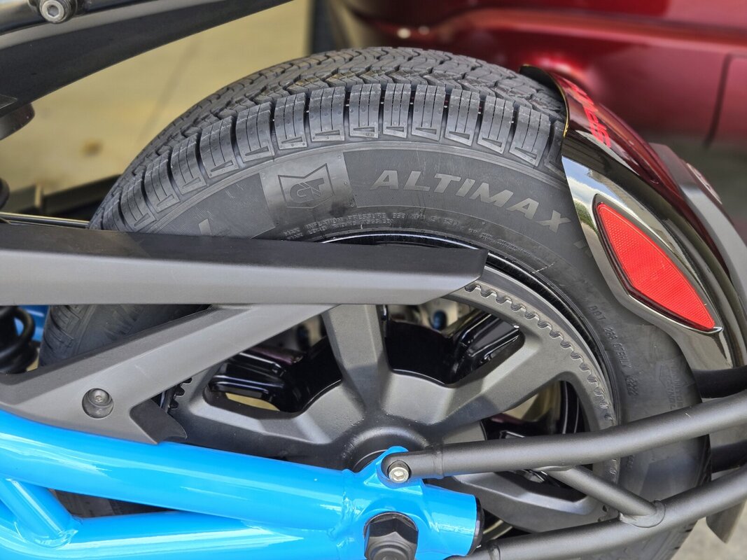

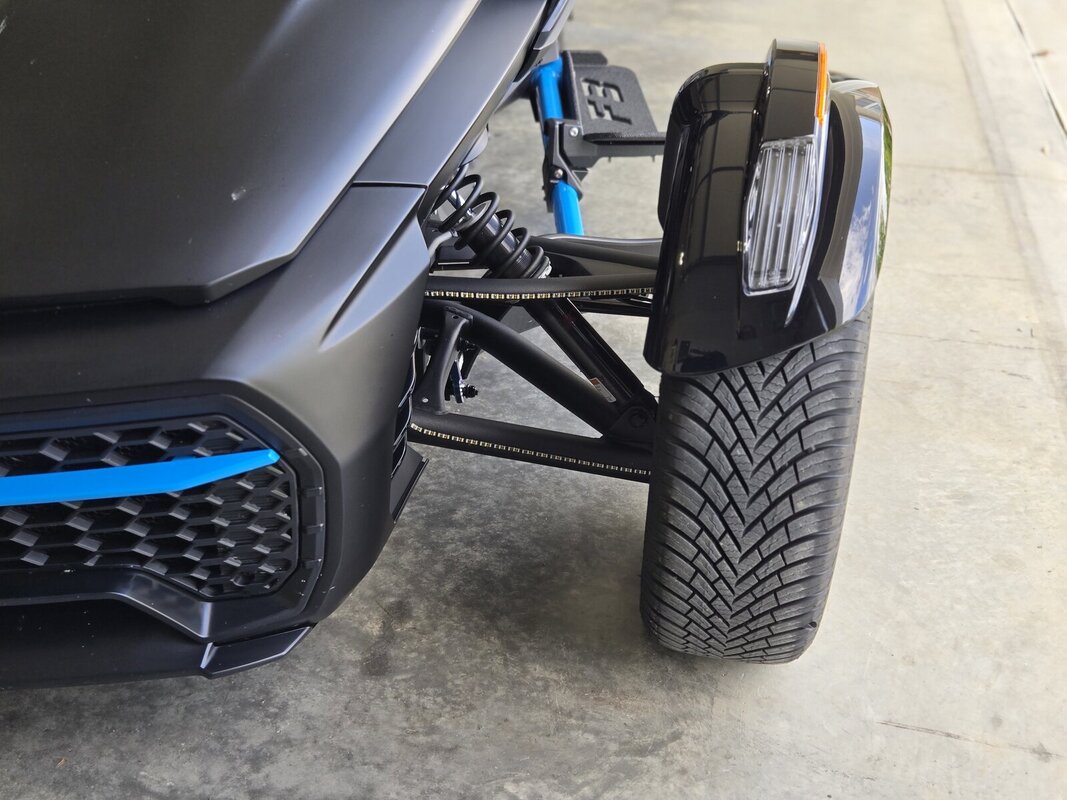

New CAR TIRES for the Spyder F3S!
There is no 'Darkside" when it comes to Spyders as they come from the factory with car tires.Your rims are labeled "J" type, a car rim designation by DOT. The tires are labeled "Special Motorcycle"so they won't be used on a car. Their construction is so light they would be unsafe on a car. You will find that your Spyder will do better with these better tires. Try running your fronts at 15 - 16 and your rear at 18-20 lbs air pressure. Because of the strength of real car tires you wo'nt need as much air to support the weight of your Spyder. I get 30,000 to 40,000 out of my rear tire and I have never worn out a front tire, I just wanted to try something else after 30,000+ miles.

Just an update on my car tires I had put on. 1,000 miles and no sign of wear. I'm digging it.
I'm running 18 psi front and back. The ride as far as comfort goes is superb. Very comfy. As far as handling goes, they hug the rd great. I've been in rain several times and feel very confident in there traction. I have spun the rear wheel a few times (not intentionally) at a light when it was raining, but I have my pedal box set at Sport III. The throttle can be twitchy on this setting. It was kinda fun going sideways though lol.
