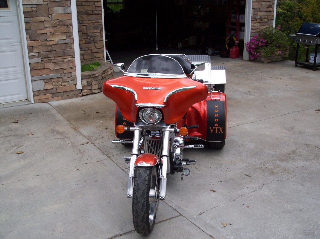

Our BH trike parked in front of "The Falls".

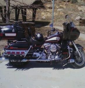

1989 Harley Davidson tour glide ultra

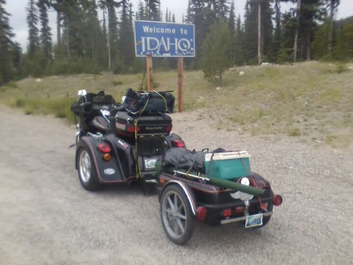

My cousin and I At the lost river drive in at Arco, Idaho 2012, He still rides his old 1986 Yamaha Venture Royal/ Craters of the moon Nat. monument on my old 1989 tour Glide ultra.
idaho%20trip%20sept%202001-#!4-%20Arco%20Id_%20darrel%20and%20I.jpgpaul-idaho%20trip%20sept_-2012-#12%20-craters%20of%20the%20moon.jpg

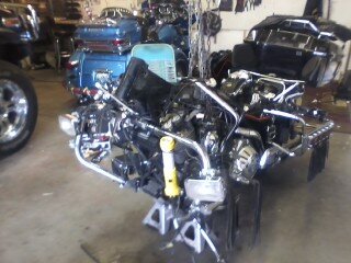

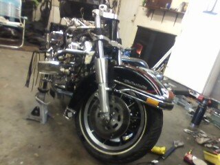

Stripping down the front end and removing fairing, fuel tank, lowers etc. to get at the wiring under the console and remove front end.
front end removed
installing new 5 degree raked Hog Halter triple tree.
going back together with front end
reassembly, wheel finally on the ground again!

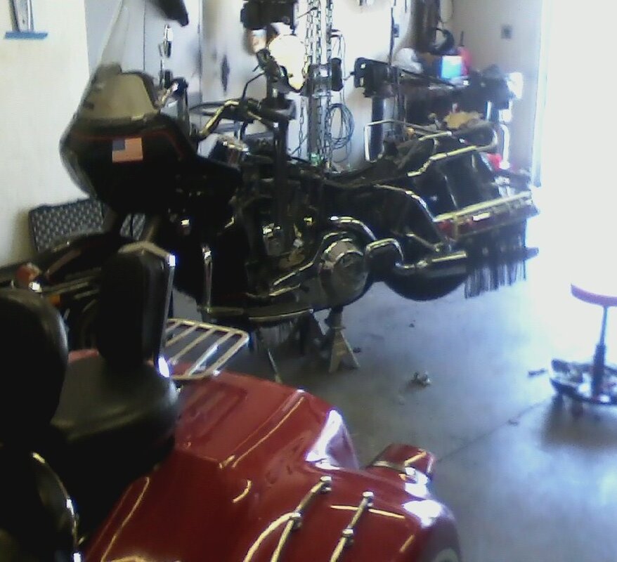

Front end finished, this will have proven to be the most difficult part of the conversion, It actually took me longer to accomplish than the rear end.- preparing to Take down the rear end of bike to begin trike conversion.

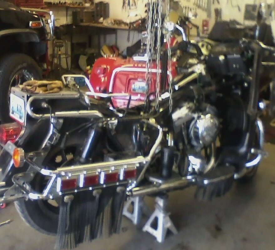

I don't have any fancy bike lifts, just gotta do it the old fashioned way. Jack stands and chain hoist. Allot of laying on the floor and stooping over on wheeled stools.
Very glad I have a chain hoist, air tools to save time and a torch, plasma cutter and wire feed welders.
Wheel off the ground so I can disassemble and mark wiring, exhaust removal.
Just gotta remove my rear fender so I can get to the swing arm for removal.

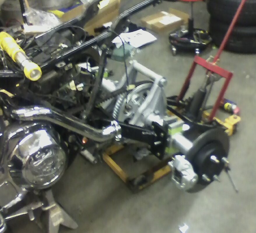

My Champion straight axle kit finally arrives, Christmas in may!
What a wiring nightmare! I loved every second of bleeding hands! I took lots of pictures of the wiring inside of the console to help me remember how it all went back together.

Installation of Champion swing arm and solid rear axle.
Utilizing floor jacks with assembly.

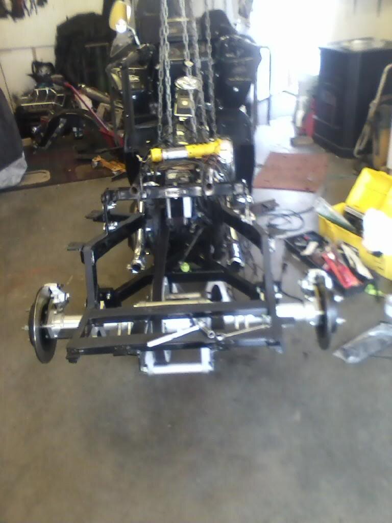

loosely bolting up the trike body frame and getting everything squared up and level so I can do a precise placement of the frame welded bracket to support the trike frame.
frame completed and stock air shocks re-installed. Still have chain hoist attached for safety. It's still on jack stands and I may get a little muscle involved.

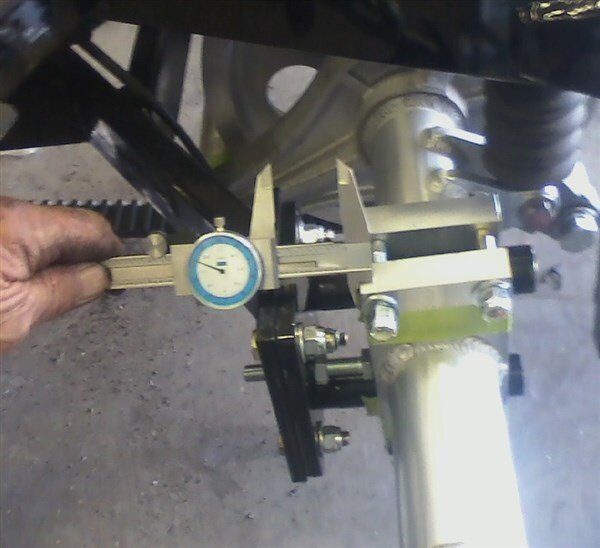

It is back on its wheels and ready for test rides, after which I will re-torque all bolts and check axle alignment, belt tension, and wheel torque.
d-7-checkingforbeltplay-oneandahalfinchplay_zps58475571.jpg d-8-usingadialcalipertoadjustalighnmentonaxleanddrivepulleys_zpsfd2f8067 (600 x 548) (2).jpg d-2-weldingbodybrakettobikeframe_zpse0c0fbb5.jpg

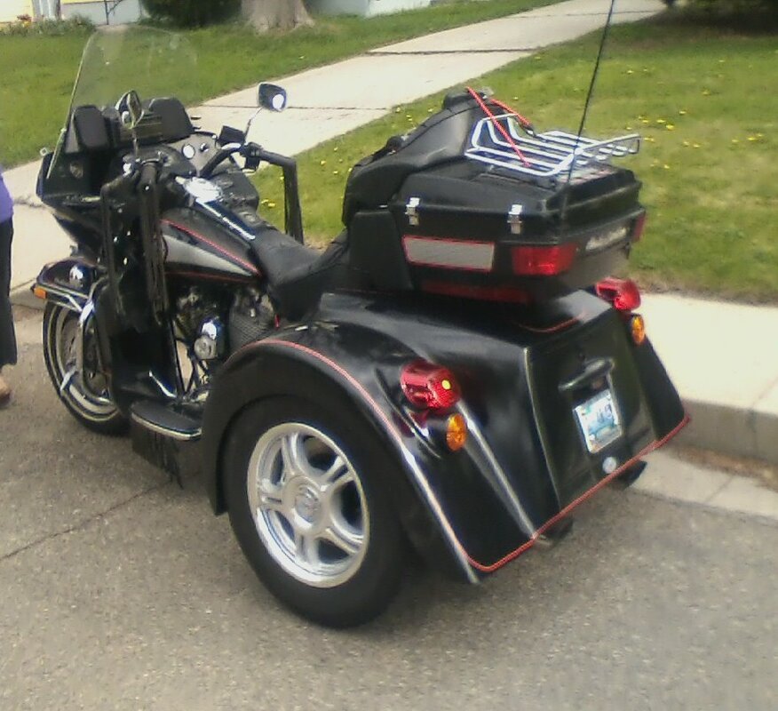

Final product.
MY WOLF IN SHEEPS CLOTHING:D
My new 26 yr.old Harley Trike. I built this for the highway not to bar hop.

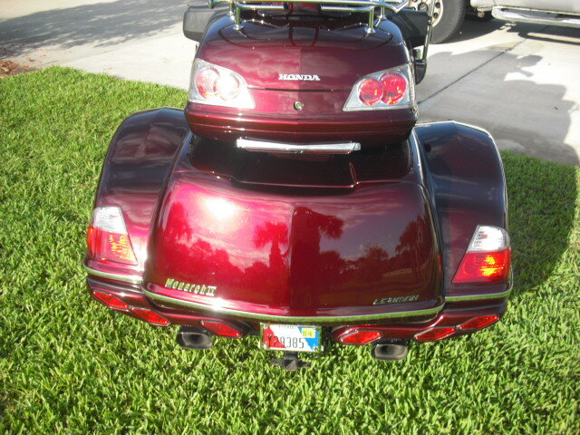

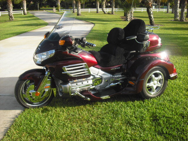

when I got my o8 the only ad on was arm rest

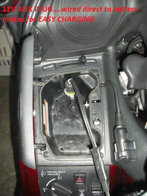

A few of the things added: Drivers backrest, highway pegs, sheepskin covers, ring of fire, turn signals in mirrors, under trunk running/brake light, cig lighter/with usb charger, converted trunk running light to turn signal . (I have 6 turn signals per side for add visibility.) Auxiliary lighting controlled with photo cell and relay. NOTE: pic of rear lighting almost appears amber in pic but is all RED in reality
tr1 031.JPGCIMG1531.JPGCIMG1534.JPGCIMG1547.JPGCIMG1557.JPGCIMG1563.JPGCIMG1566.JPGCIMG1569.JPGCIMG1567.JPG
