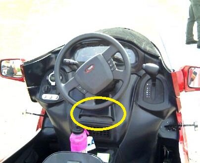

Those are part of the interior lights that came on the plastic bodied Stallions. There is also a light under the steering column that shines down into the cup holder area. There is a toggle switch just beside the light beneath the steering wheel that turns on all 3 lights (unless someone has disconnected them). I "borrowed" the attached picture of a Stallion from online & circled the area with the switch for the lights. Hope that helps.

I have been out with my wife putting a bunch of miles on the Stallion since I last visited Trike Talk. I appreciate your input. Tomorrow I am going to try your suggestions about one switch controls several lights. I knew about the switch under the steering wheel but it hasn't been dark enough when I tried it to know if it does in fact turn on the interior lights and maybe even the trunk light. I have a lot to learn about the Stallion and I am looking forward to each thing I find out. I also have a question my wife asked. Is there such a thing as a Stallion rally where a lot of owners get together to exchange info and ask questions? Just wondering! I was asked about my Stallion number and it is 740. Thanks again
