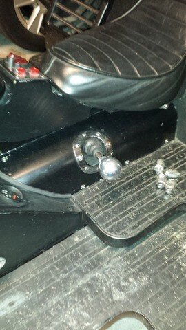

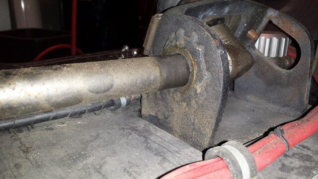

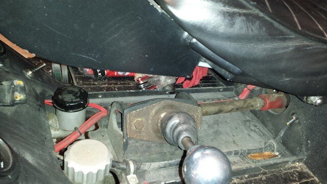

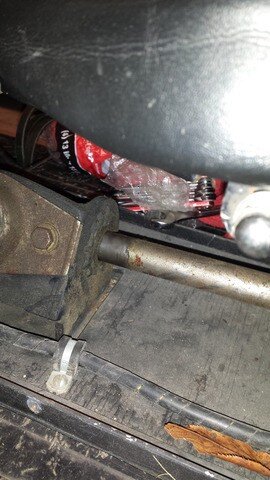

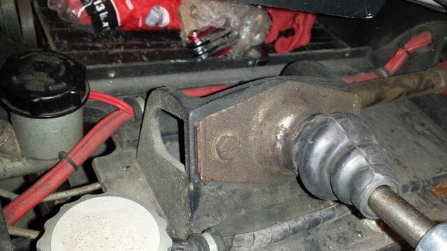

Hey gospicker I'm not able to get the email to work out right. The files are too large, so I sent them with dropbox, which I obviously didn't figure out correctly. Just posted them here instead.
Thanks Matman, I haven't been on the site for awhile. Work seems to get in the way of my social life around here!! The photos are great and very helpful. Thanks again....gospicker
