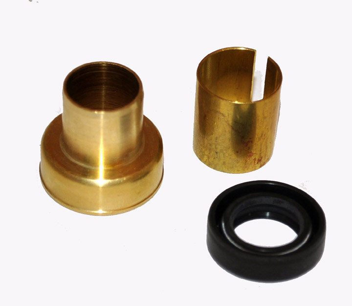

I found the culprit. This is the bushing and seal that fits on the end of the nosecone, it slides over the shift rod. For some reason it was binding, I suspect the seal had become hardened and had somehow shrunk. I removed the bushing and seal and the transmission shifts as it should. I bought all new parts to rebuild the shifter assembly since it's apart. The split bushing goes inside the nosecone so I won't be installing that.
