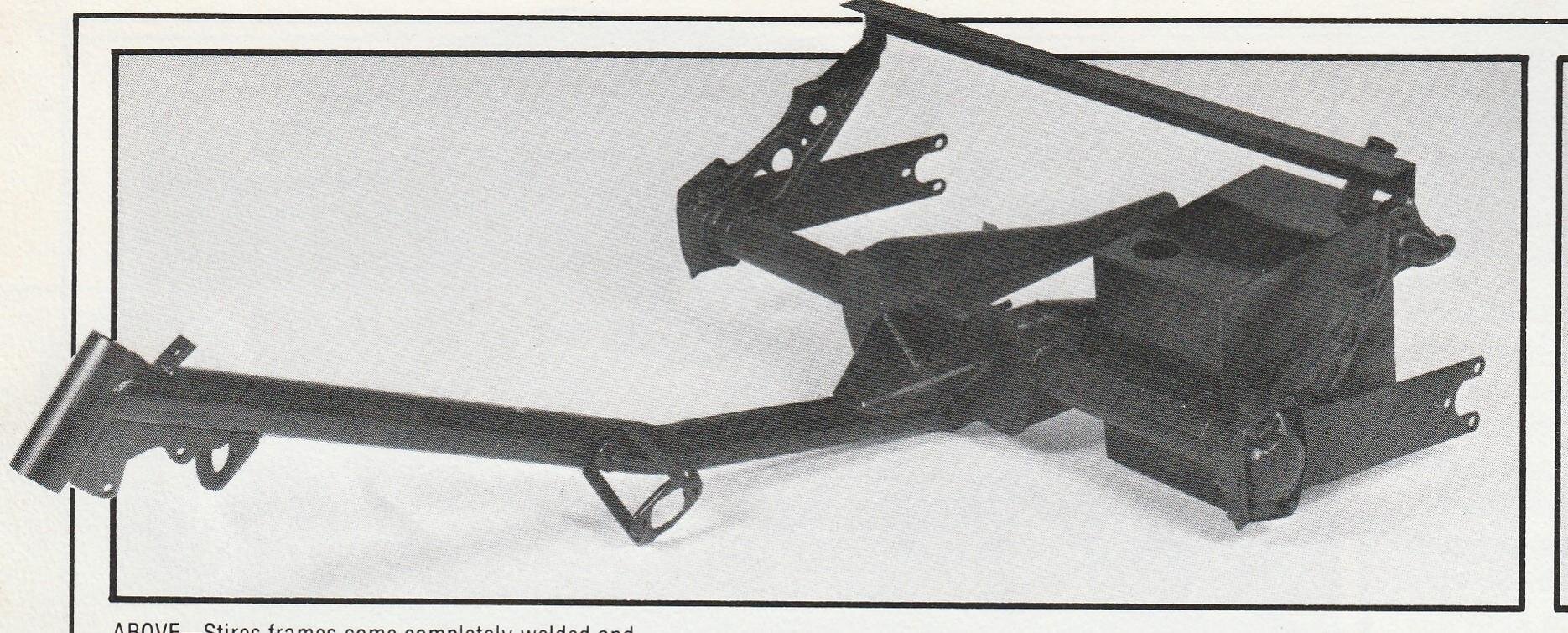

Here's some pictures of the Stires Stinger Trike. It was the closest "Roth Clone" that I'm aware of.
Here's the frame:

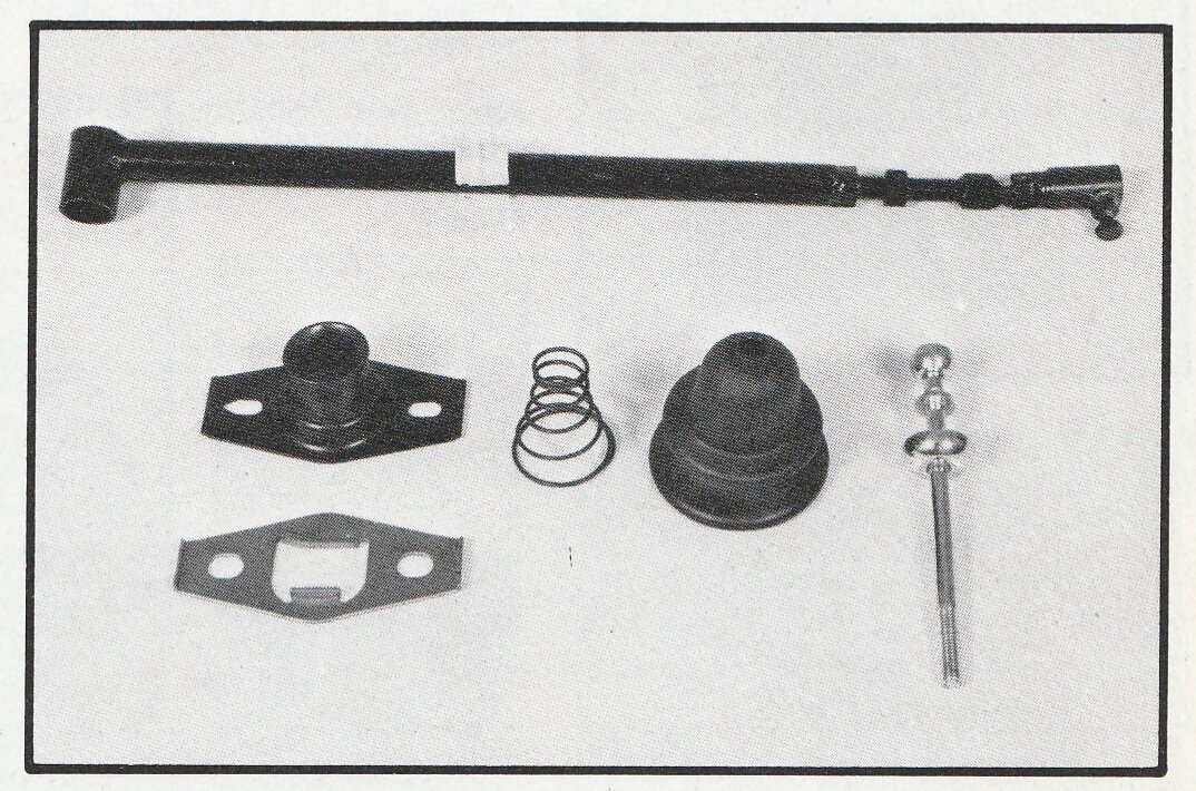

Here's the shifter:
These pictures are from a 1973 Stires Catalog. Hope this helps.

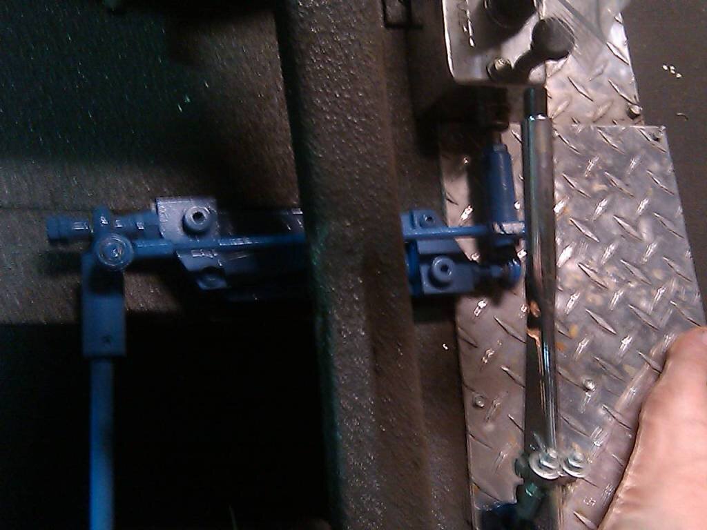

Dave Shuten. (One of the head restoration guys at Galpin Auto Sports) let me take a good look at a couple of Roths personal trikes they have on display there. And another one they are restoring. Pretty crazy setups. But I did come to realize that i may had been overthiinking it a bit. My friend at Prowlers (buggy and sandrail builder here in Santa Clarita, Ca) modified a stock bug shifter box to be supported on the front and the rear with heavy duty bearings. That, combined with two u-joints (kind of like you suggested) should work fine. I hooked it up and tested it (static). And it seems to work fine.
