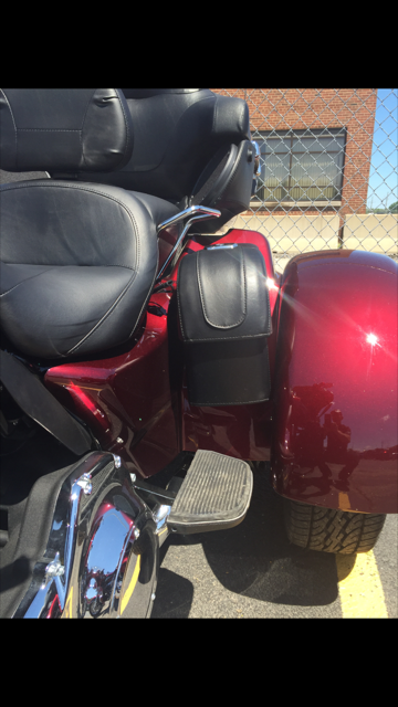

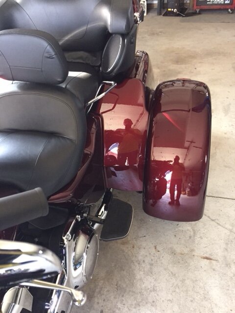

The day the trike was delivered I immediately pointed out that the bags were mounted crooked. I told the dealer that I didn't know of any way that they could straighten without drilling extra holes and that would be unacceptable and I wanted a new body installed. They procrastinated and wouldn't commit to a course of action. Took trike for 1,000 mile service and didn't even look at the bags after picking it up till 2 days later

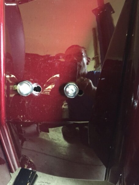

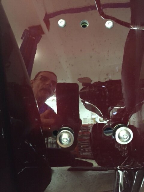

(had been working 12 hour shifts for the past 2 weeks) low and behold the bags had been straightened. I was horrified when I removed them and saw the extra holes. Dealer was notified and went to general Manager level. It was agreed to remove a body from a new trike on the floor and replace mine. I did not have them reinstall the bags. I now have installed My self using the See Through Braz no drill mount. What a long and painful process to get to this point.

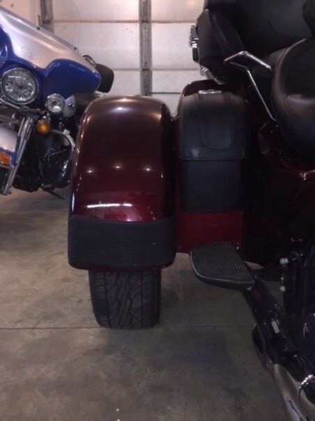

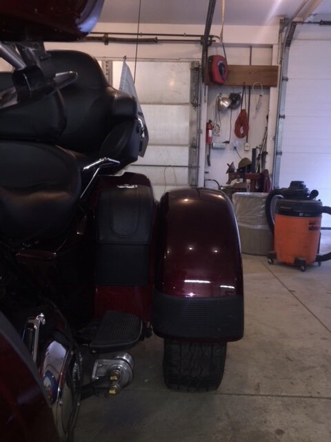

Long Journey to get to today , Dealer really botched install and then botched the attempt to correct. They installed a new rear body section to satisfy me. Installed SeethruBraz velcro kit , it was ok but most likely due to surface contamination I didn't properly clean I had it peel off a couple times. SeethruBraz sent replacements no charge ,they are definitely a great company to deal with. Reading other posts about people who used the plastic type of velcro like ez pass , i purchased some and it seemed better with not peeling off. However it wasn't holding the bags themselves well , never had a problem riding solo but they seemed to get knocked of when a passenger was riding. It was worse when riding in 90 degree plus weather. I took about 4 hours of marking and double and then triple checking and checking again and checked one more time and finally drilled and mounted the Harley hardware.

That is the tape I used , no problems with the vhb peeling it was actually the velcro to velcro connection that was not holding well. Knowing that the template was off I made my own reference marks and centered the holes and leveled the center lines. It would also be possible to get the bottoms straight but while marking the top per instructions the bags could rotate and cause the top hole to be off and then the bags would still be crooked. I cut a 3/4 spacer and held between the bags and the fender to keep bags parallel to the fender while marking. I do think the bags are overpriced but what isn't from Harley. They are handy for quick access storage , I would miss them if I had left them off.

...... I now have installed My self using the See Through Braz no drill mount. What a long and painful process to get to this point.....
Dang good choice utilizing SeeThroughBraz products. I've been using their stuff for years now. Al and the gang are great to deal with.

The very first set was installed crooked - per the instructions. Hopefully H-D has corrected the instructions. The dealer fixed the problem by re-drilling the bracket on the back of the bags and not the body. Expensive??? How about the windshield pouch = $130 and can barely put a pack of cigarettes and a pair of reading glasses in it? Now that's expensive.
