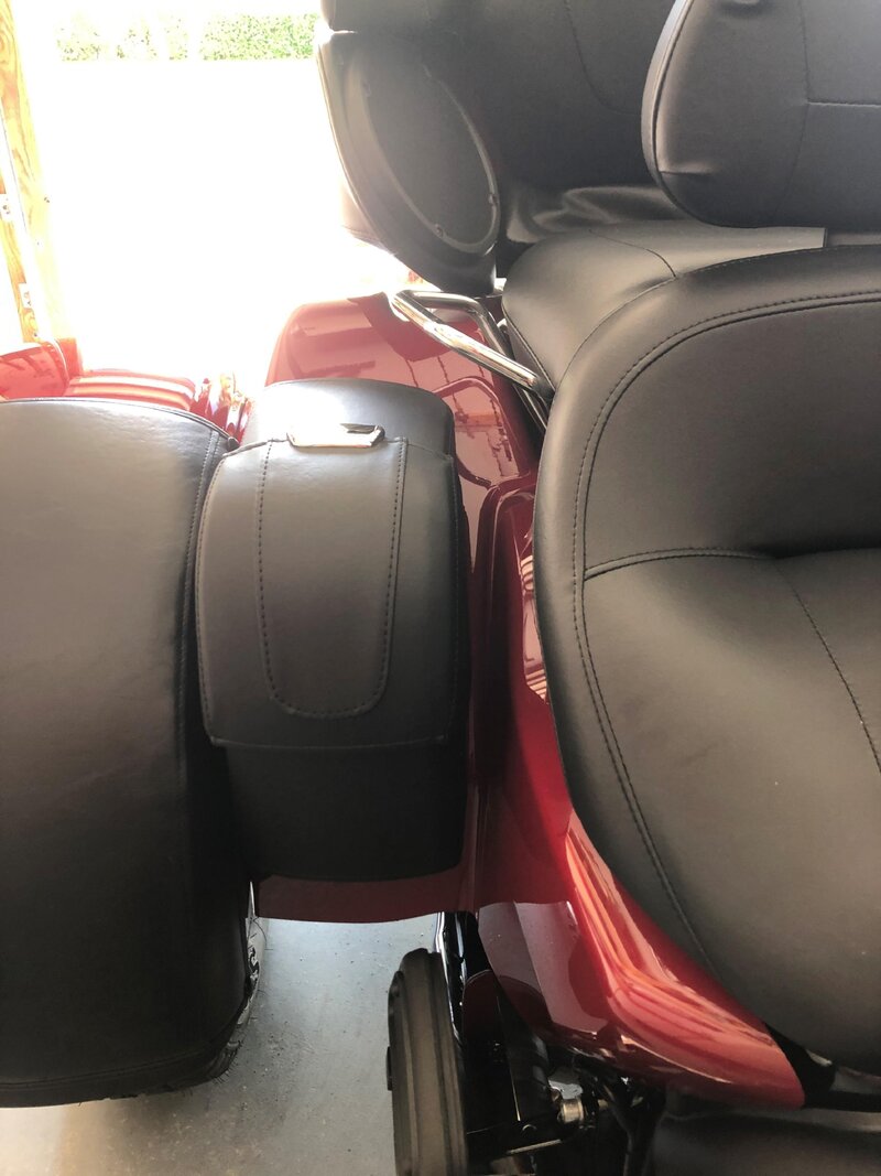

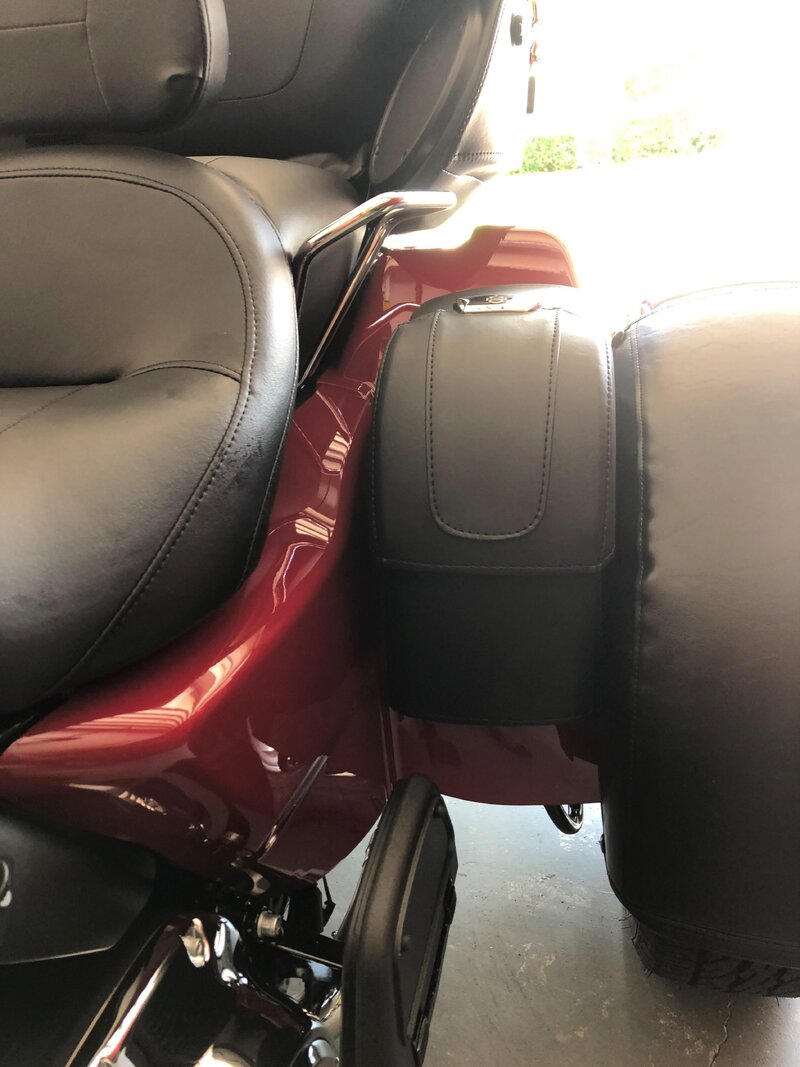

Installation complete
UPS dropped off HD saddle bag kit yesterday,so I dived into the installation this morning. I took my time and taped off lower break line on inner panel and then aligned template per instructions. Marked lower holes and drilled with a step drill instead of a regular drill bit. Once holes were drilled and attachments bolted in place,bag self aligned itself for final marking for top retaining bracket. I did find I was unable to locate and attach upper bracket without removing wheels. Once I had wheels off,one side at a time, installation was so much easier. The outcome of the installation all depends on the alignment of the template to the break line. I am very satisfied with the looks of the bags and know I will utilize the storage space.
