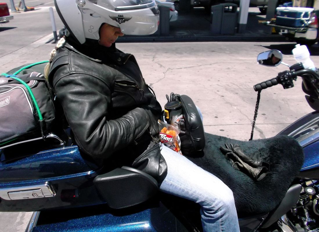

I've seriously been considering these. We don't "need" them, but it sure seems like it would be really nice for Mary to have some extra room back there. Right now she just has what she can stuff into my backrest pocket and her jacket pockets.
Two questions for those who have them-
Do they ever get in the passengers way when mounting, dismounting or riding?
It seems you need to remover them in order to remove the side panels, if this is the case, how difficult is this?
Here's a pic of her with her typical "stash".
TIA
