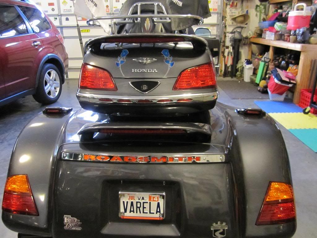

I just now finished installing the LED spoiler I bought from Tony's Trikes on the Roadsmith main trunk. It looks great! ThumbUp
But I'm so damn sore now I haven't even taken any pictures. :AGGHH:
Photos soon to come. ;)

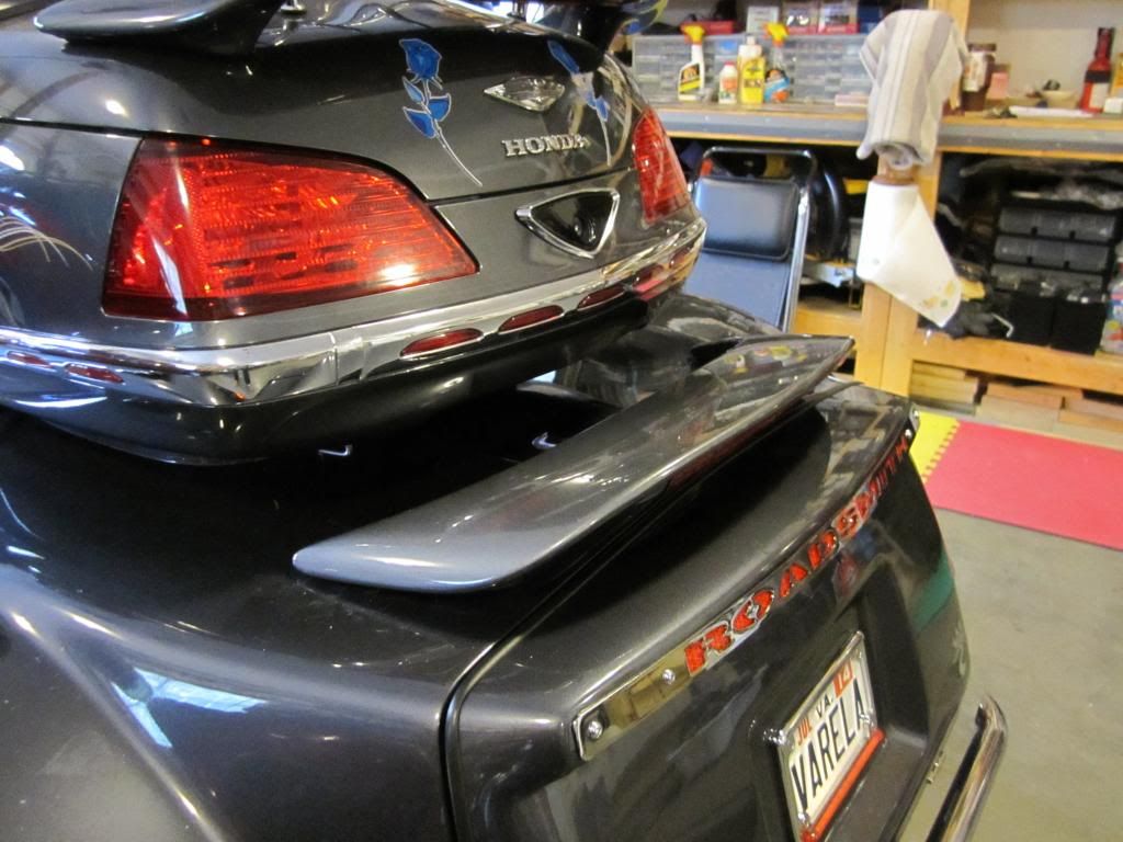

Update. Went out to the garage for a fast photo shoot. My back is still hurting, so unfortunately, no riding today. Here's a few photos;
I LIKE IT!!!!! Goes GREAT with the trunk spoiler.

I first saw this spoiler added to some of the Roadsmith units on Tony's Trikes web site. I always wanted to put some kind of spoiler on the Roadsmith main trunk. The top of the trunk is basically flat and even looks like some additional option should be mounted there. After I saw these added to some of Tony's RS units, I immediately called him asking if it was a new Roadsmith option. Tony told me it wasn't and that many of his customers were always asking if an additional spoiler could be mounted there. He's tried a variety of different offerings but so far, the standard Honda Spoiler that gets mounted on the stock upper trunk works the best and the fact that they both match each other just makes it look like it belongs. I'm very satisfied with it. :)
Spoiler looks very good. You buy it from Tony? Or just from a Honda shop with your paint code. You install it?
I bought it from Tony and gave him the paint code for my trike. You can also buy it from him with just a primer coat for less money. I also installed it as per Tony's instructions regarding correct placement and drilling. Tony will tell you that it can only be wired as a running light or brake light. (It only has a ground and hot lead) There is a way to have both and I have mine working as a running and brake light now. If you decide to get one, send me a PM and we'll further discuss all of the install details.
