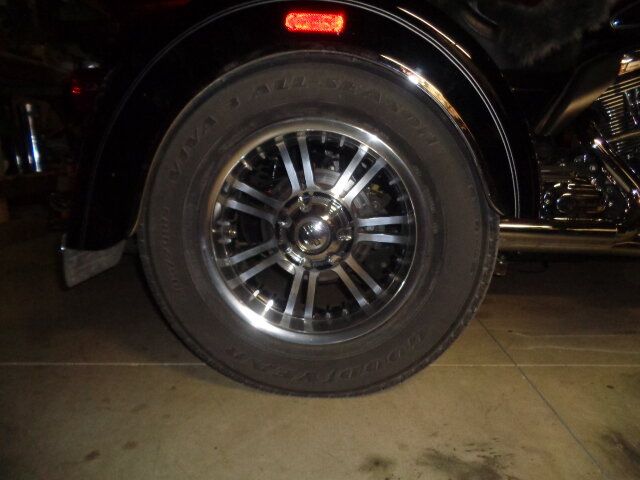

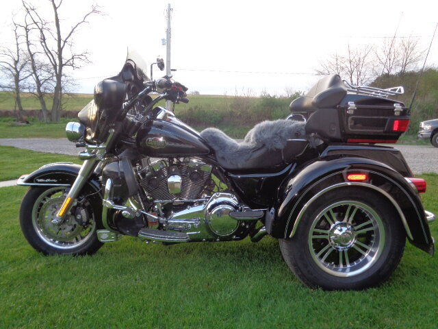

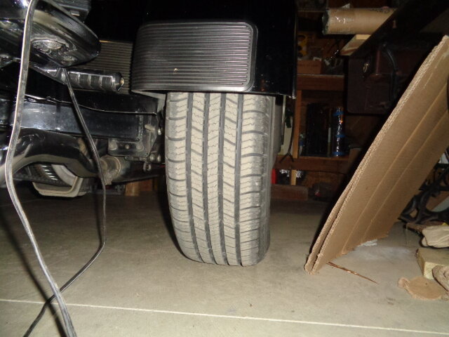

I just installed Viva 3 Goodyear 205X70RX15 Made in the USA. Gearing change I think it is a great change, the tires are quiet and solid in turns.They increased ground clearance app.1/2" speedo 2 mph slower. actually seems to corner better than before with the new shocks and tires who knows. :cxtv: travel safe. Fred

do the 70 give you any better softer ride
I do believe they are as good as... if not a little better. It's really hard to say I changed to the 70 series to drop rpm's at 65 mph and faster. these Viva III are quiet handle well in curves and don't dog walk on open grid bridges. I swapped shocks from OEM Air to Pro Action so the ride improved 1000%. I can't say the tires ride softer when you change more than one part. I will say I like the rpm's I run in sixth gear now. The motor is not screaming at 70 MPH anymore, still at 2700-2750 it just seems to be pulling strong. I made the change for gearing if it rides better great the shocks gave us the ride and especially after I did the fork kit from Pro Action as well it now handles extremely well for an Old guy and a ten year old trike. I do know that the front tire has more traction on curves than it has ever had with the higher tires on the back an excellent Plus as far as I'm concerned. Ride safe Fred
I picked up theses viva III on sale for a little bit of nothing figuring if they didn't work my utility trailer would get them. I will wear these out on Old shiney LOL...
