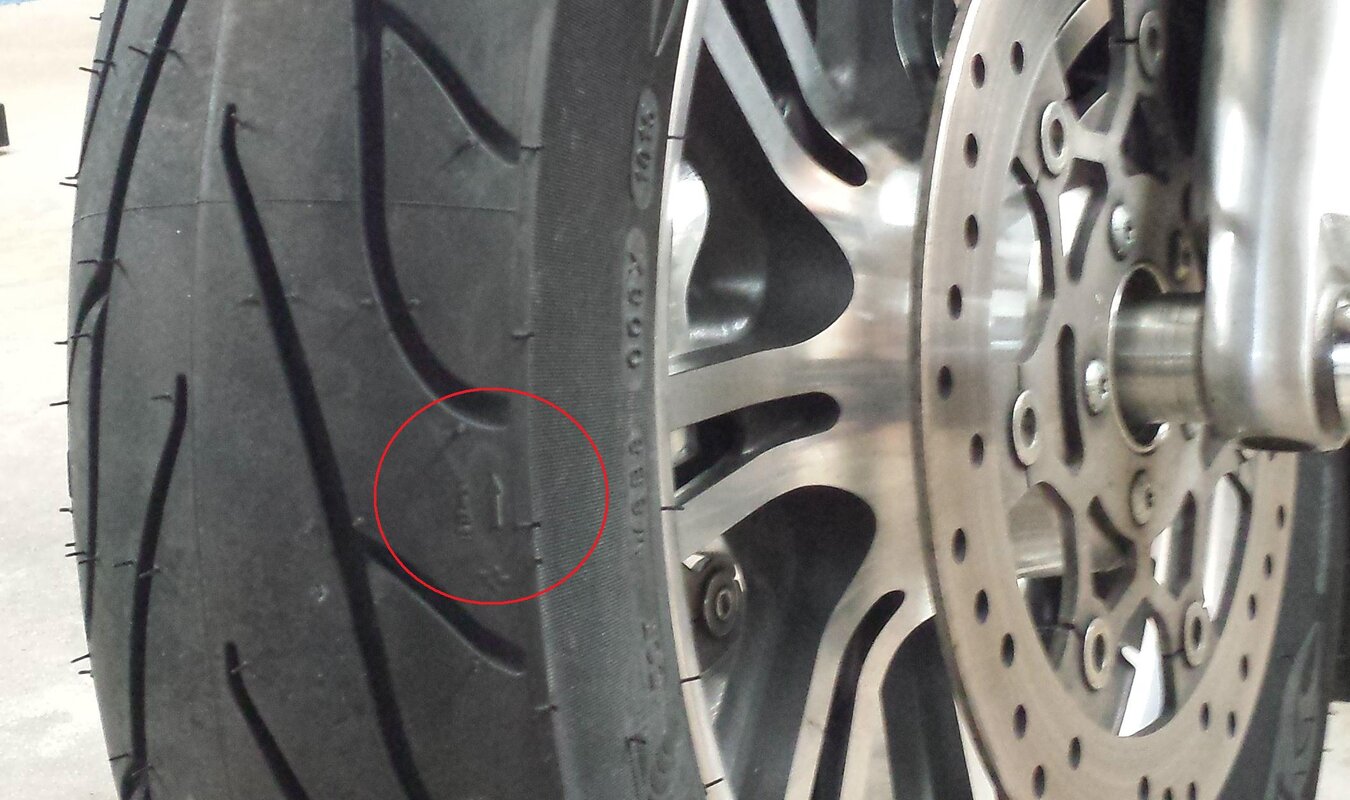

My Michelin Commander II rear is mounted in reverse rotation .. PER MICHELIN"S INSTRUCTIONS for mounting a rear tire up front.
If you look close you will see the direction arrow on the tread near the sidewall.
I am extremely happy with how this tire rides and handles the corners.
