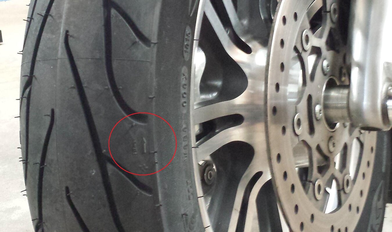

I'm running an American Elite Rear tire up front on my '14 TG. It is an MT90B16 which is 130mm and there is very little clearance left.
I'm running a Dunlop Elite 3 MU 90 B 16 rear (mounted backward) and there's about a 1/2" between the fender and each side of the tire. I wasn't able to find another tire that was 16", but this tire handles and wears so well I'm going to replace it with the same thing when the time comes unless the new Avon turns out to be leaps and bounds ahead of the mileage that I'm getting.
