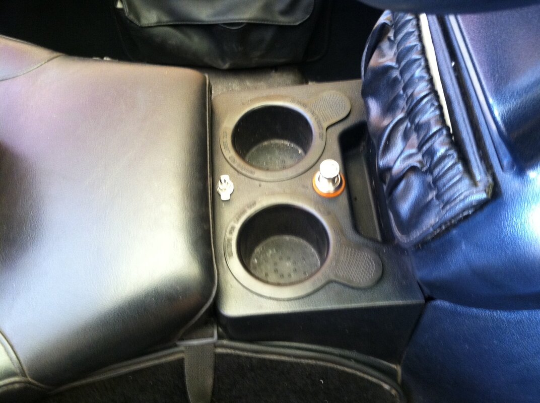

photo (26).JPGI installed a manual switch as plan B just in case it happens again.

That should take care of the overheating/fan not kicking in. I added the manual switch, but still keep an eye on the temp gauge and "test" the switch periodically to make sure it is active, in case you ever need to use it.

Hey Dean H. Good idea on installing a bypass switch!!!
