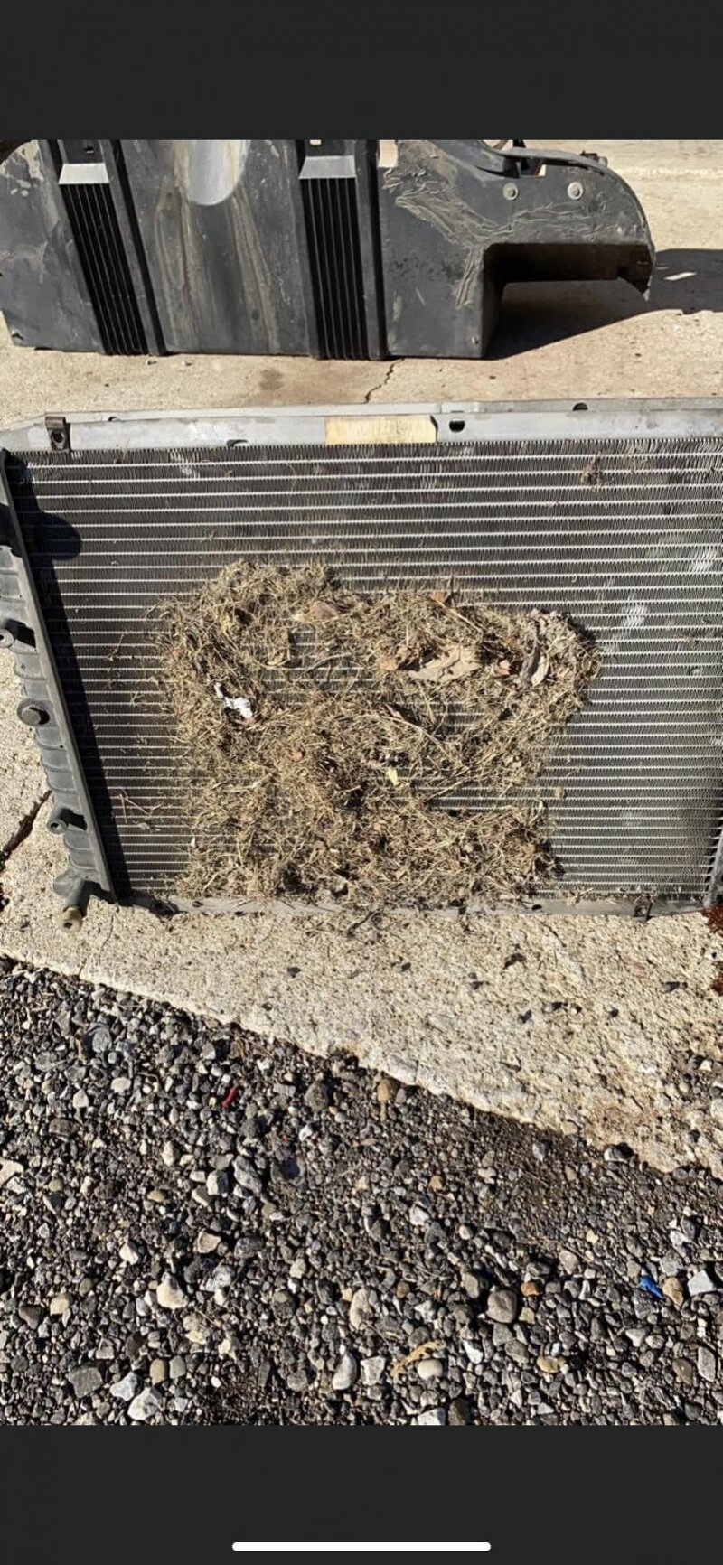

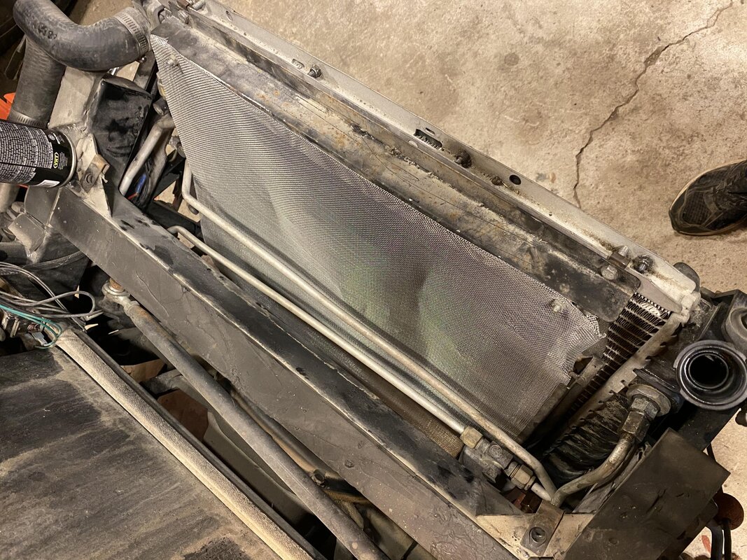

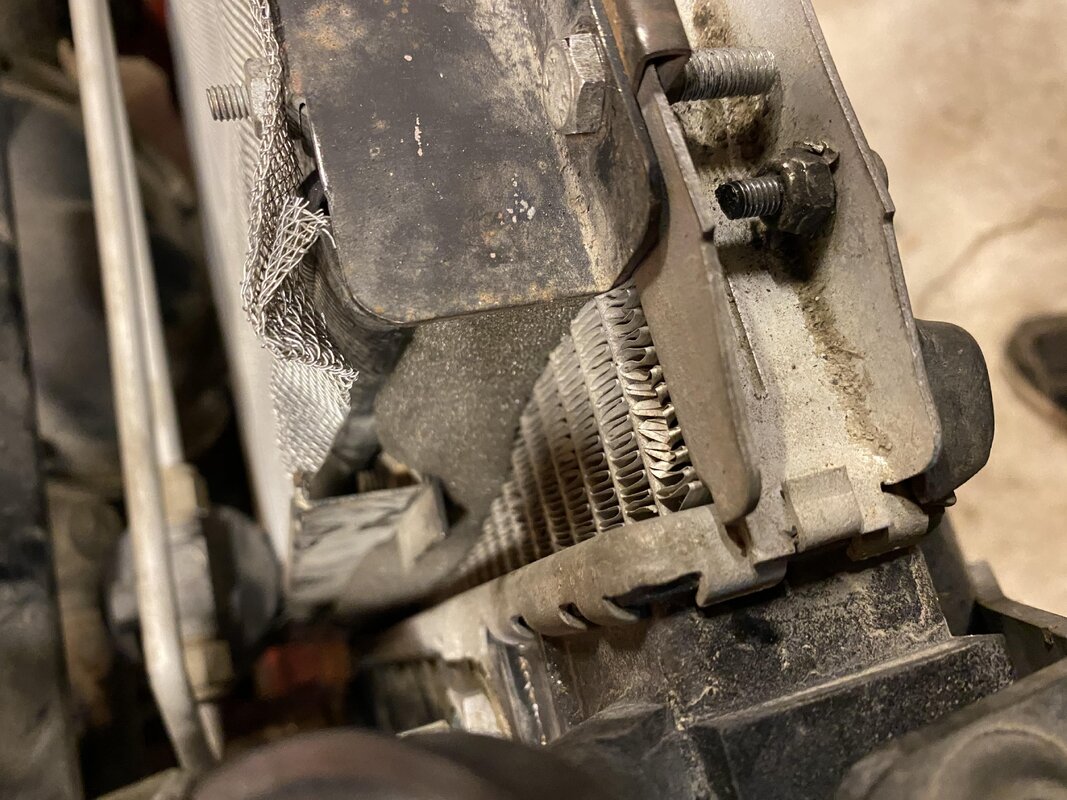

B3BEAEBB-F8CF-4DEF-AD13-023A6F3B1310.jpgI had noticed that the cooling fan was kicking in awful quickly but I hadn’t owned it very long and thought maybe it was just the nature of it. So I had to do some repairs to the back of the inside trunk so I took it all apart. After I got it apart I noticed the condenser was full of grass clippings! So I decided to take the radiator out and clean it. Very glad I did cause the radiator was full of leaves and grass! I noticed that there is a space between the radiator and condenser and the grass and leaves were being sucked between the two and plugging up where the fan is sucking air through. So after cleaning it all out I put foam in between them on each side to block the gap so nothing can get sucked past it. I also bolted a screen to the front of the condenser to help keep it from sticking in the condenser. I will try to post pics of before and after of what I found and fixed. I got 1 pic but can’t get the other 2
