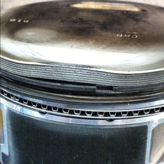

Where the majority of the tuners check temp is at the base of the spark plug, you will be surprised at the difference in temp between front and rear. A good tune will normally come in around 300 degrees in this area, the rear will normally run 40 degrees warmer. You can get them a little cooler with lowers removed, except its not an option on the liquid cooled Twin cam.
