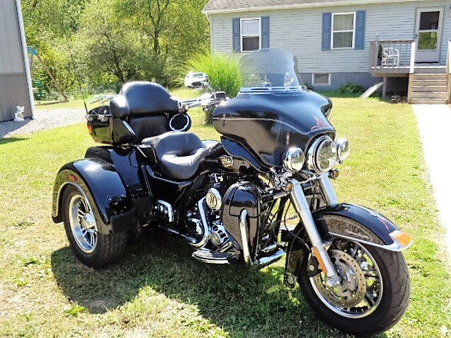

Air pressure varies with the size of rider and passenger. For my bride and I at our size #36 front tire #22 rear tires #36 to#38 day trips and longer trips we raise shock pressure as load requires. 1 to 2 lbs. difference can make a huge difference, in comfort. It takes a little work to find what works for the individual machine and riders.ThumbUp ride safely fearless
