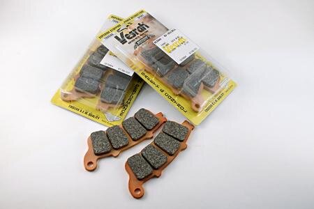

Honda OEM pads will get you about 20 - 40 K depending on your braking style, a hard rider less / I hate changing pads that quick so I opt for Traxxions Vesrah Pad Kit :
http://www.traxxion.com/GL1800-Brake-Pads/
And always get close to 40K with very little brake dust..... Great Pads
