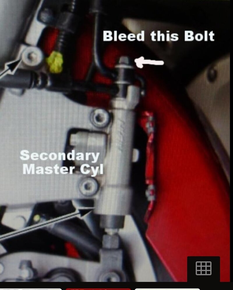

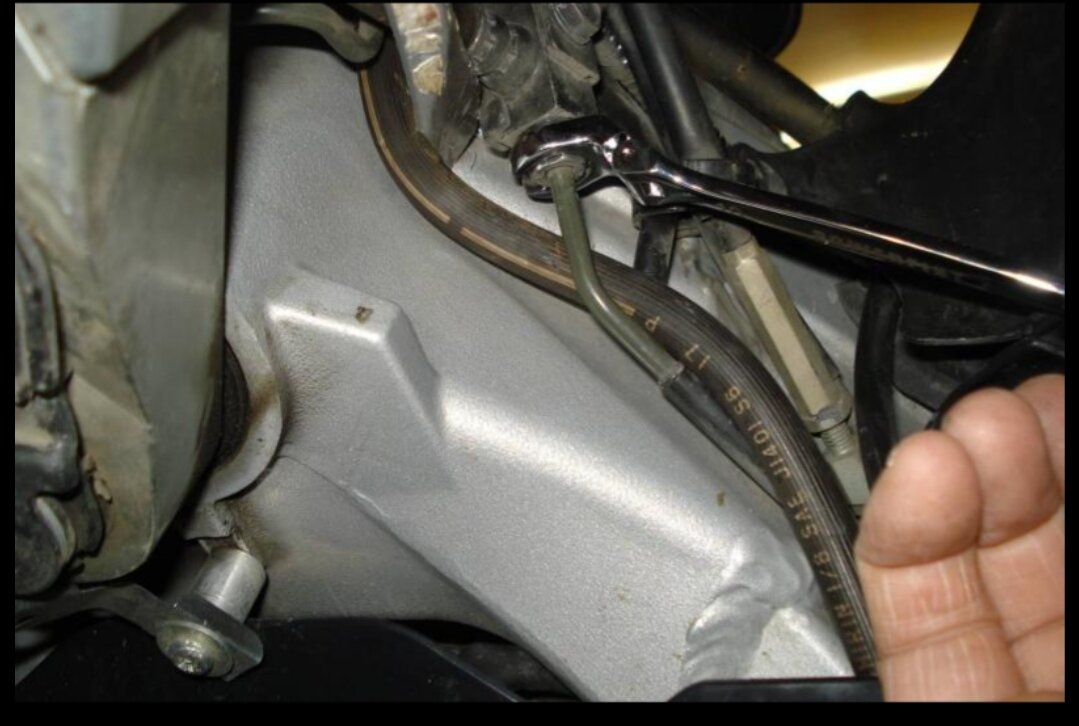

6: Pressurebleeding the lower Junction block. (Upper left side of frame sitting onbike).Follow rubber hose from Secondary master cyl to the Junction block.
7) Pressure Bleed the top Banjo bolt on the Secondary Master Cyl.(To be sure the air bubble is completely out)
STEP-6 ( follow the hose from the Secondary Master Cyl up to the Fitting on the block you need to bleed)

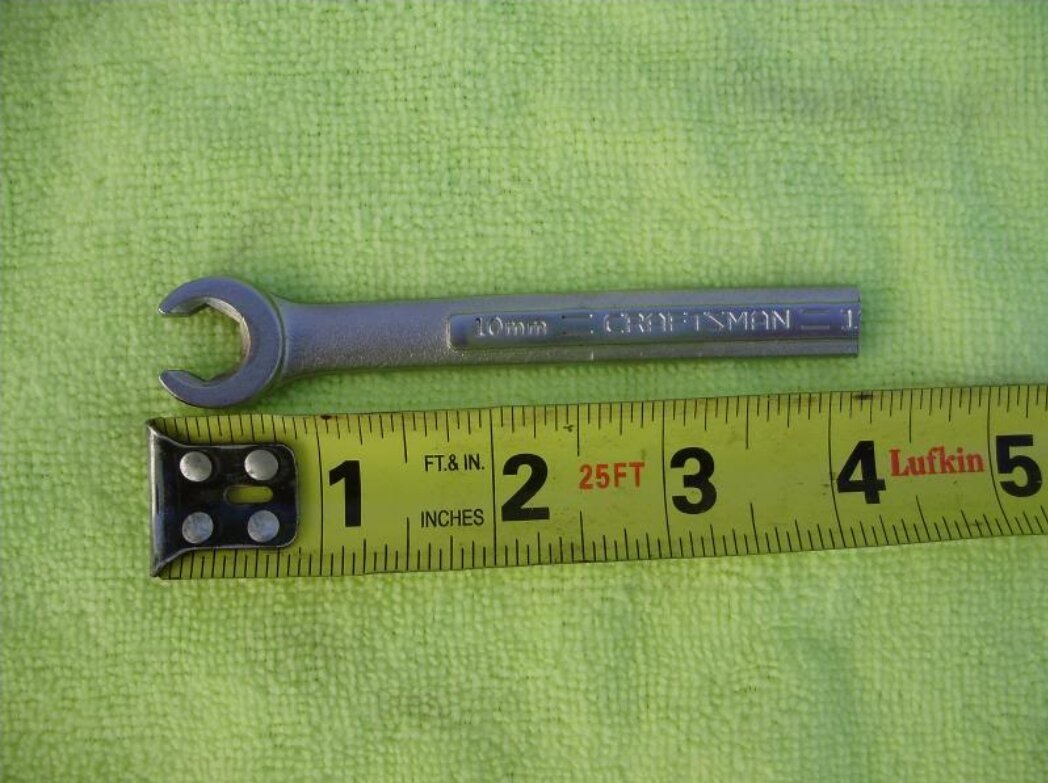

STEP -7 (I use a rag over the wrench when I bleed steps 6&7, and have a spray bottle of water handy to neutralize the brake fluid after bleeding them)
