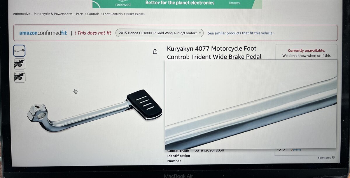

I think the OP was looking for a cover that would go on brake pedal to make it wider instead of replacing the whole arm. Unfortunately, that brake pedal is no longer available. Ever since Kuryakyn got bought out by Tucker Powersports, the Kuryakyn parts especially for the older Goldwings seem to be drying up and no longer available. And looks like Tucker Powersports sold out to Turn 14 Distribution which has caused Kuryakyn parts supply to shrink even more.
Thanks for the link but it comes up as not a fit for a 2015.
It actually will fit a 2015. Amazon gets the fitment wrong all the time so I take their fitment option with a grain of salt. They are wrong more often when they say a part won't work for your vehicle.
The OEM pedal used on a 2015 is the same I believe for the 2001 all the way through 2017.
Just a quick tip, if I am concerned about whether an aftermarket part will fit, I will look it up on Partzilla and below the parts description, they will show all the years and models that part works for under "Diagrams".
But unfortunately, as I mentioned above, that is a discontinued Kuryakyn part and every place I checked showed it out of stock.

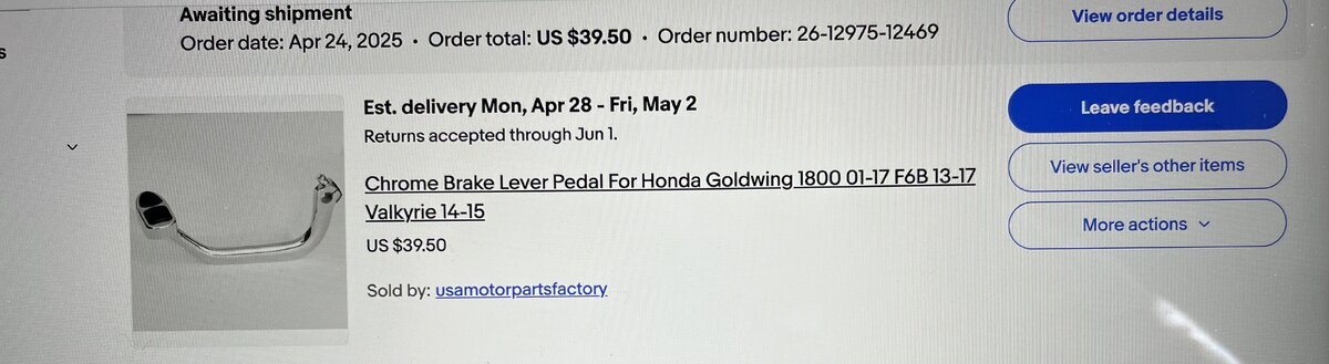

I bought the Kuryakyn 4067 yesterday; and today I bought a pedal and stem (see attachment) which I hope is the one Dave said I would need. (fingers crossed)
They both should be here by the 2nd of May. I will keep you posted. Thank you Dave, Val & Mike for your legwork.

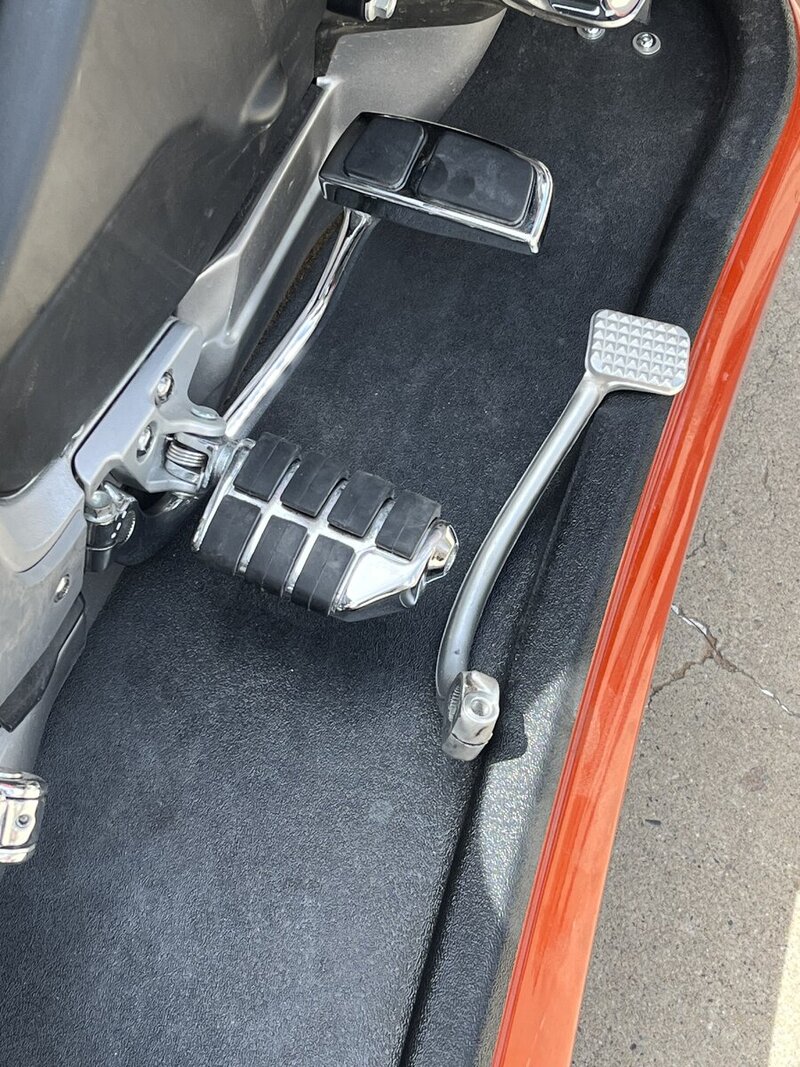

DCTruncale aka Dave: Thank you again for telling me what Kuryakyn part (4067) was the Kury larger brake pedal I wanted but didn't know existed. Below is a picture of the large pedal on the Kury brake lever attached to my trike with the original pedal to show the difference in pedal surface area.

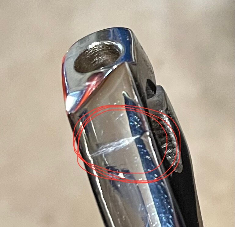

The second picture is of the first 4038 brake lever I ordered off Ebay. It came in looking good - it was a new fake Kury. I knew that going in, but thought it would work. I had trouble with it right away. There must have been some burring on the one I received. I could not get it started on the spline. I tried to separate the lever at the split a bit to allow it to slide on but no luck. There was no tension in the metal - my prying opened up the split and created a stress crack as seen it the second picture. I break about as many things as I fix so it could have been me using the sledge hammer instead of the framing one. In this case though since the new fake Kury was all aluminum it just bent. I didn't discover the crack until after I had given up trying to seat it.
The second one I ordered I ordered from a salvage yard and had my fingers crossed that it was an original Kury. I got it today and it just slipped on the spline like it belonged there.

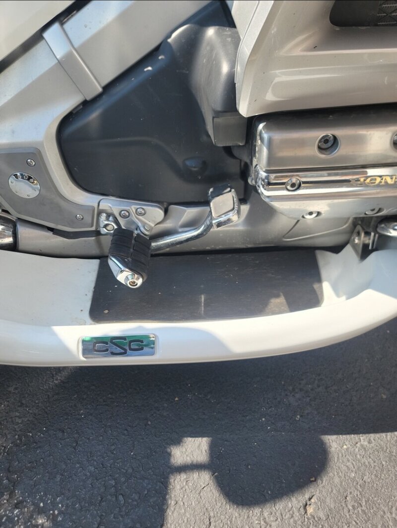

This thread inspired me to give it a try. I bought both the Kury brake arm and the wide replacement pedal. So far it seems to work well. I also have the replacement Kury driver pegs. I mounted the brake arm as far up as I could and then angled the driver pegs down in front. It's actually pretty comfortable. I can easily fit my hiking boots below the brake pedal and that gives me a little comfort. When I need to brake, I just pull my foot back and raise up the ball of my foot and can push the brake pedal down. The first few times I did push a bit hard on the pedal and slowed a bit quicker than I wanted but am getting used to it now. The rear brakes seem much firmer and better stopping power that my 07 did. Not sure if it's because of the addition travel of the brake arm but it works good.
