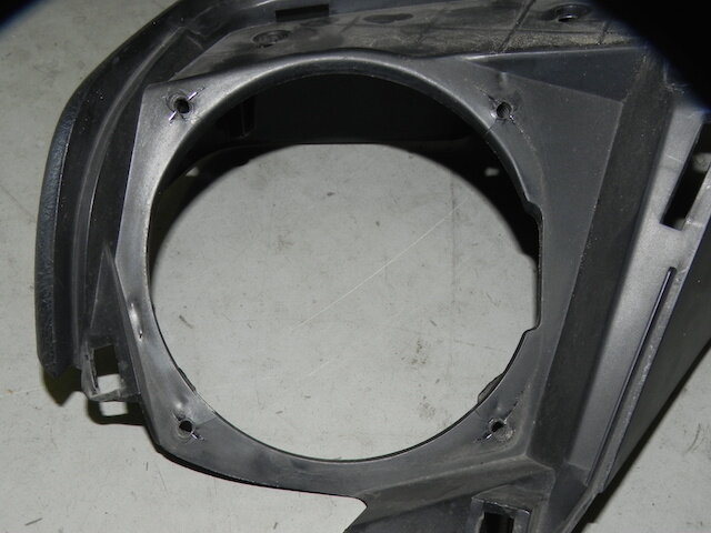

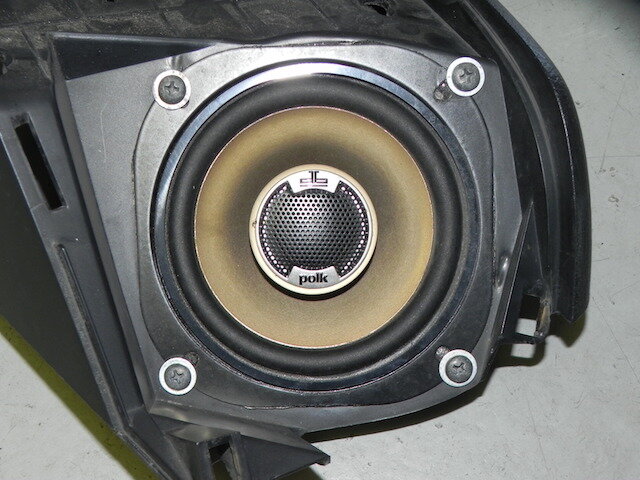

I always find "unexpected disappointments" with aftermarket accessories. Often, the disappointments are not discovered at first. In this case, I installed Polk db501's passenger speakers 3 years ago, and am in the process of replacing them when I find cracks.
disappointments:
- short life, they only lasted 3 years before no more sound

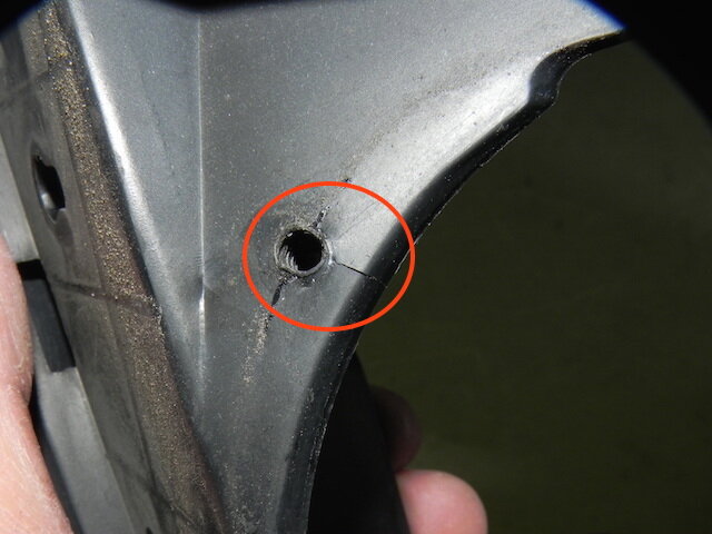

- their weight has cracked all 8 mount holes in their armrests

No, they are not specifically designed to fit a GL1800. They're a common upgrade many use to get better rear sound out of a GL1800. The OEM and J&M's are designed for GL1800s, but they become screachy after a while. The Polks used are marine grade, they sound considerably better, but they go bad after about 3-4 years in my climate. I'm sure the plastic breaks because of the weight of the larger magnets.
