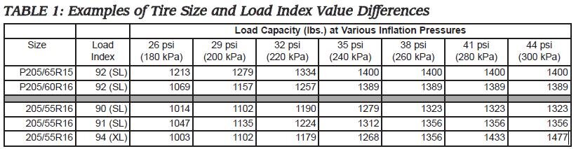

We do not all ride solid axles, a majority rides IRS. The opinions here have been formed over the years from thousands of trike owners, riding many thousands of miles on every make, model and brand of trike and sharing that information. The best ride is going to be in the low to mid 20s of rear tire pressure. This pressure is perfectly safe and better suited in every way. Read this article from Lehman, it backs this up:
http://www.lehmantrikes.com/assets/docs/uploads/Manuals/techbook-master.pdf
I have been riding a trike for a while, this is one of the best reads on trike I have seen
