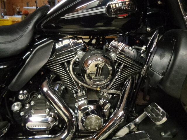

Amsoil was recommended to me, given a offer I could not refuse, try it if you don't like it oil free and they would put in anything I wanted. Neutral is always in the same place hot or cold. By the way I think the tranny oil from Amsoil is the cat's butt no more clunkity clunk, clunk when shifting. just sayin works for me. :Shrug: ride safely fearless
