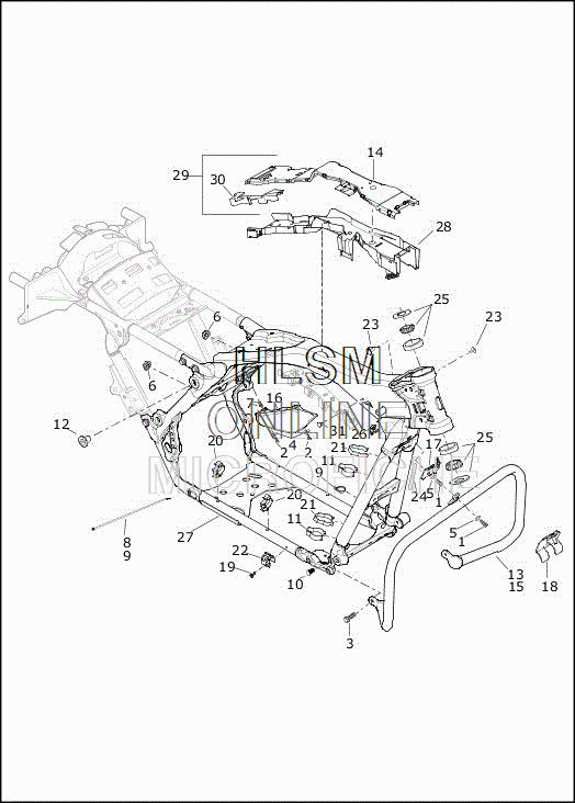

Anything is possible even tho the wires run thru the electrical carrier seen here, # 29 is the top cover to #28 fastened to the frame under the gas tank. The gas tank is removed to change spark plugs and wires. So bumping a wire could possibly happen. You might ask your dealer to point out to you where the wire was disturbed for your own reference
