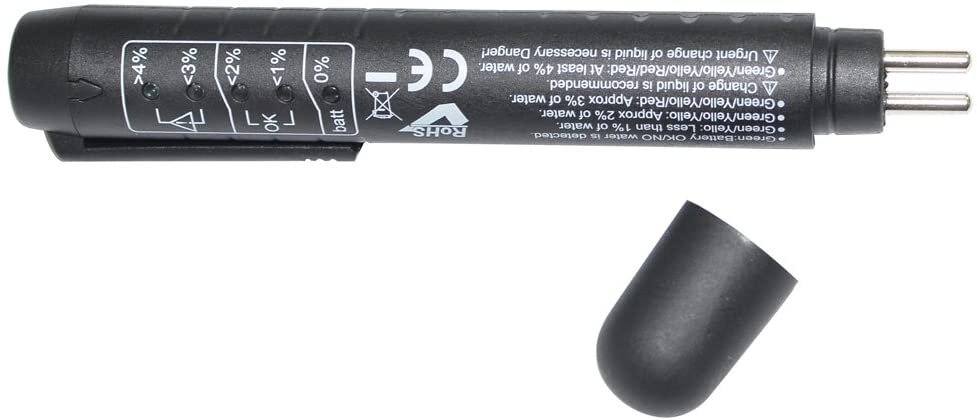

If you are mechanically inclined, get you one of these as they are a great tool and have a reasonable cost. Takes the guess work out of brake fluid moisture levels.
https://www.amazon.com/gp/product/B076SC377J/ref=ppx_yo_dt_b_search_asin_title?ie=UTF8&psc=1
Very handy tool, I have had a Mac Tools fluid tester since the 80s, not cheap but very accurate

Fluid testers are so inexpensive now there is really no reason not to have one. Tip: if you change your own fluid like I do always test your new bottle of brake fluid before using. Believe it or not Ive found brand new off the shelf brake fluid testing in the yellow zone.
