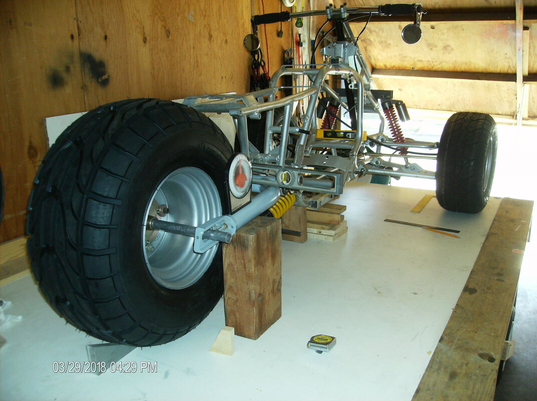

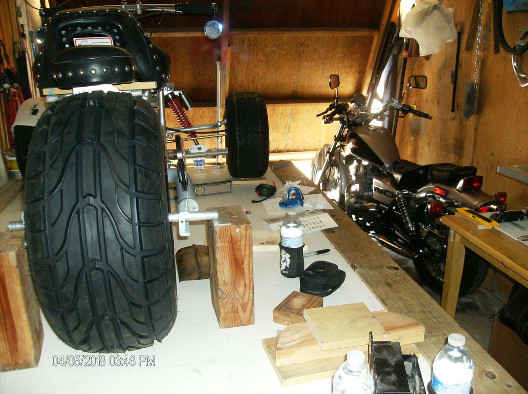

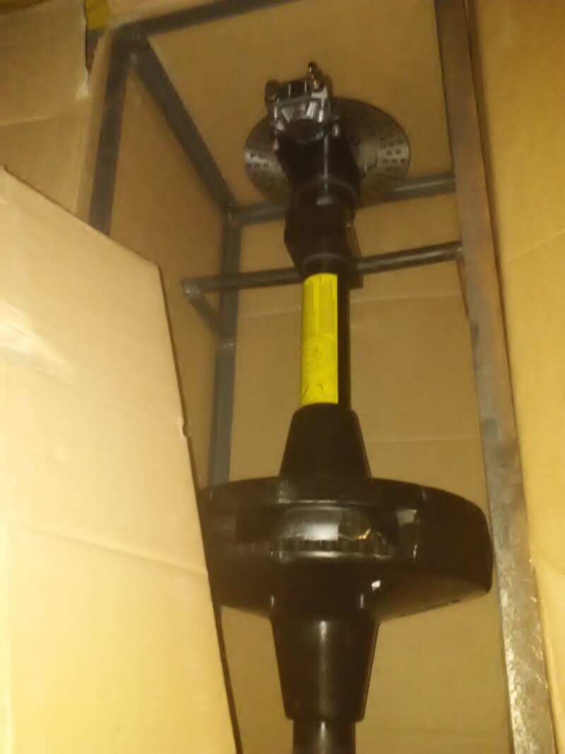

Back on build after three years!
I got tired of walking around this thing so I'm going to finish it. I'm working on a Leading Link with Dual Wheels. It is together enough to try steering (not moving). More effort than I thought, can't wait to see what happens rolling. Checks out to 2 3/8" Trail and about 5 1/2" between contact patch centers on the tires.
My thinking is to start here and narrow the width to use a car wheel if this doesn't work out. I may reduce the Trail some more. This was a less expensive way to start, second wheel, $15 + shipping off eBay and I'll use the GW brakes and speedometer. Also using the GW rear shocks. Any input will be appreciated.

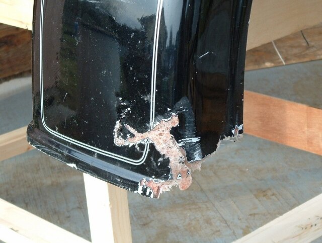

TriMuter
I built this TriMuter in 1984-87ish, I modified the original drawings and body to accept a 1600cc VW 4 speed, I learned a lot about fiber glassing and body shaping...
