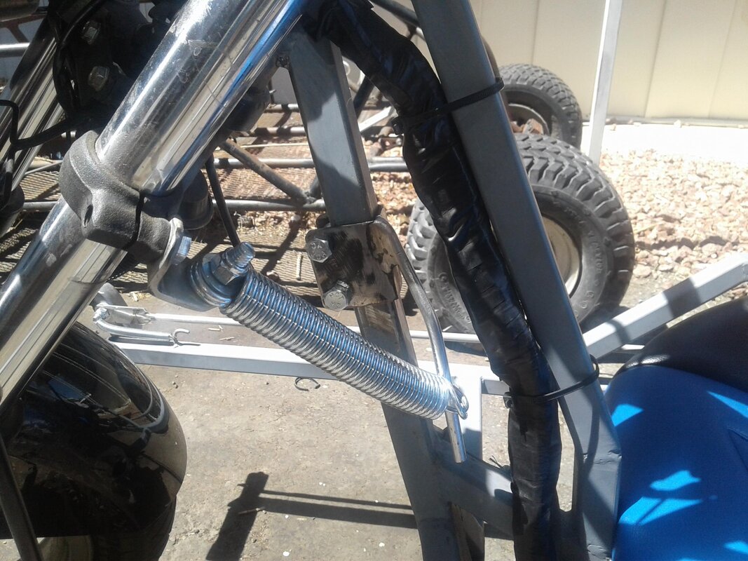

Update... turns out if you mount a heavy duty spring to the left part of the forks and bring it to the frame it will help overcome the right hand steering. It's way more manageable now vs no spring. I built a slide adjuster to fine tune the spring tension. I also had my rear wheels balanced at the tire shop. Makes a world of difference.

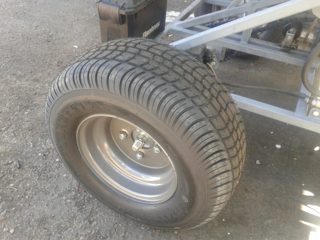

Here's a larger Tire I went with I upgraded from golf cart to trailer tires. I like trailer tires cuz they hold a ridiculous amount of weight and are fairly sticky. They provide good traction and will hold up at 80 miles an hour

if anybody was wondering how I attached my spring, this pic should clear it up. Left hand turn allows the spring to slide down the bolt and the right hand turn brings to spring up until it catches. The whole thing is adjustable to be fine-tuned.
