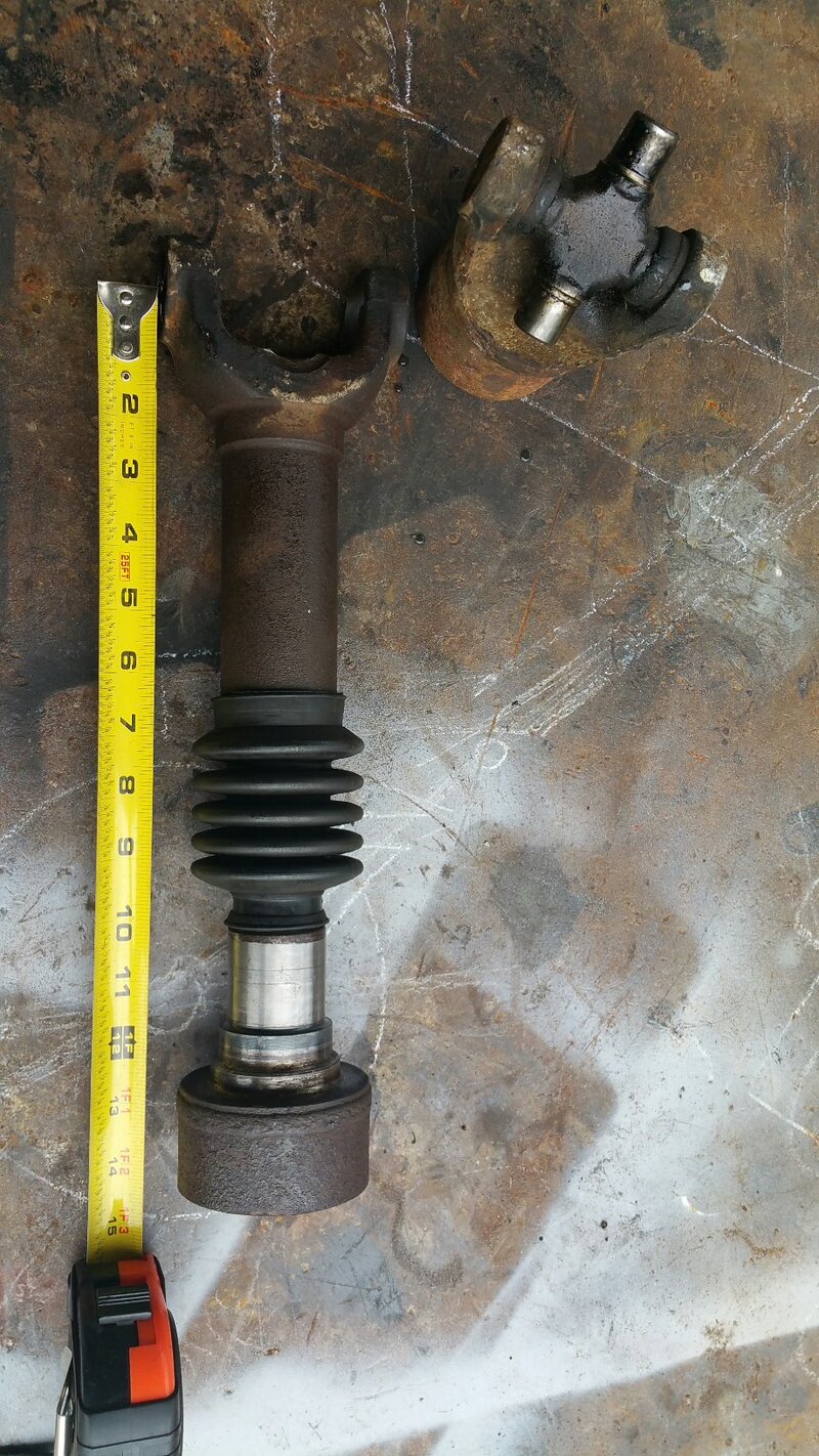

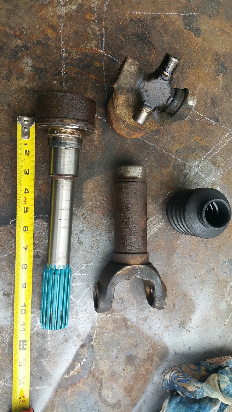

I cut the spline end off of my driveshaft. One end is good to go to fit the rear axle. Not sure the yoke size that will be on whatever transmission I can find. If my local driveshaft guys can cut the spline shaft shorter before welding it to the yoke it would cut a few inches off the overall length.2016-02-21 20.33.32.jpg
when i built my shaft i had access to a lathe and just cut the weld out and went with new tubing. Your shaft guy will be able to fix u up with what ever you need when your ready im sure

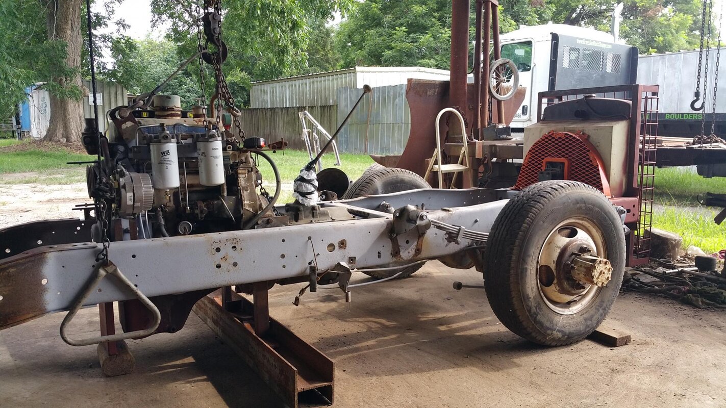

I got my transmission and last week I did a "dry fit" if the engine and transmission in the frame. It really hit home how tall the Detroit is (the pan is way below the transmission). This is causing ground clearance issues while trying to line the transmission yoke up with the pinion yoke.
I'll probably have to go with big ass tires to get extra ground clearance for the pan (33 in or larger compared to the 30 in tires I have now). I'll probably also jack up the front end an run with the frame at an angle.
With all that said. What would be a maximum safe angle to run the driveshaft? I get everything from 3 to 10 degrees depending on who you talk to. The maximum RPM of the driveshaft will be 3,000 RPM. That's full throttle in overdrive (estimated speed of 90 or more miles per hour). Cruising speed on the interstate 70 mph will see a shaft speed around 2,250 RPM.
I'm also trying to figure out if Detroit makes a low profile oil pan for the 3-53T. Any little bit will help.
I took and cut my pan down 2 inchs and just widened on outside to make up difference of volume lost by cutting the two inchs. I used a shortened pick up tube and added baffles to slow oil running forward on braking. I was working for a low center of gravity as i sit on top of engine. Heck i even cut down intake to lower carb so i could put on air cleaner. With your welding and metal working talent im sure u will come up with a fix:clapping:
