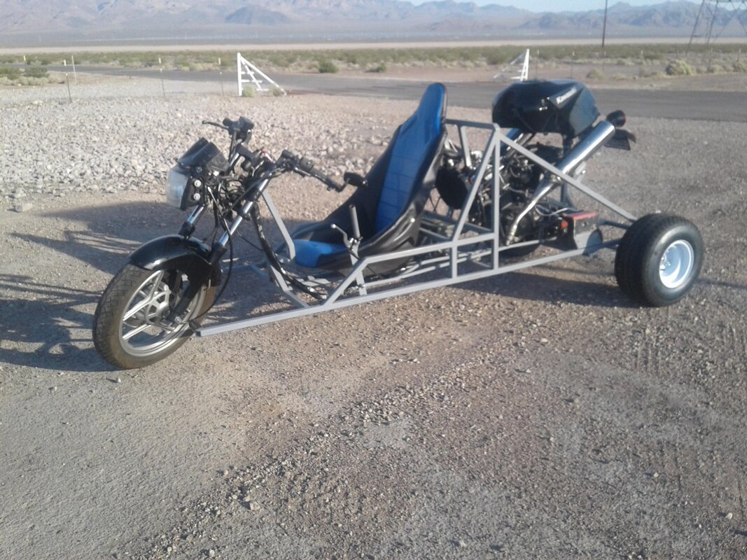

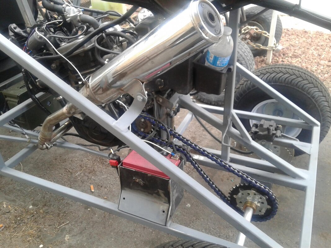

I'm thinking maybe I will install a bicycle shock that goes from the Triple Tree to the frame on the right side. That way I might be able to overcome a right turn at slow speeds with force on the handlebars but it may be enough to offset the constant right hand push under acceleration

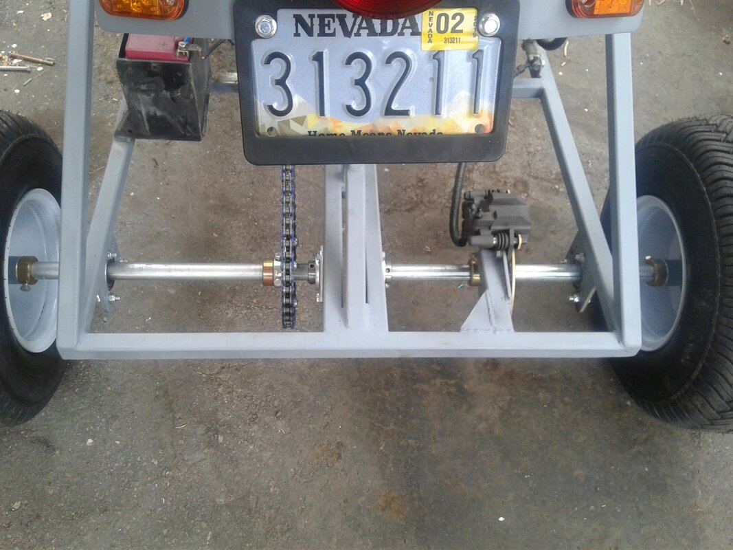

It has a solid axle supported by 4 bearings that's cut in half. Left wheel turns with the motor, right wheel has the disc for the brakes.
Looks like a converted go cart . 8” or 10” rear wheels. If used on the road, I’d make it a live axle using pillow blocks . Will be a rough ride on the ol back.
You cannot use a live axle on a trike it'll go in a straight line when you try to turn. I know from previous experience. My only other option would have been a differential. The only reason I live axle works on the old school off-road trikes is because the tires slide over the top of the dirt. That won't cut it on the street
