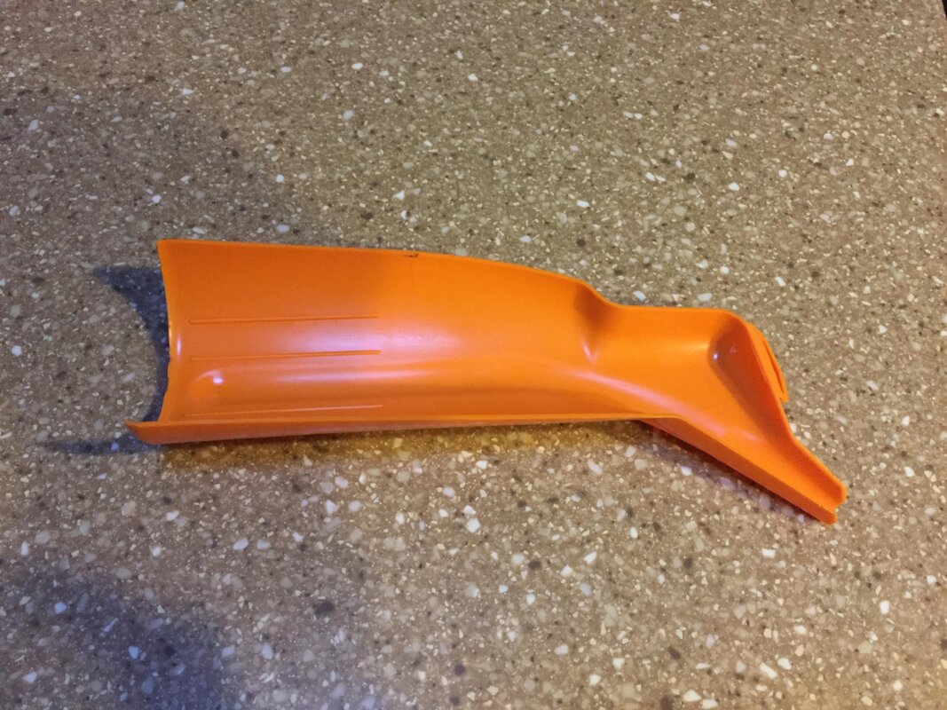

i bought the erst trough and it works better and is cheaper than the HD one. i then notched the erst one so it goes in farther, punch two holes and let it drain.
