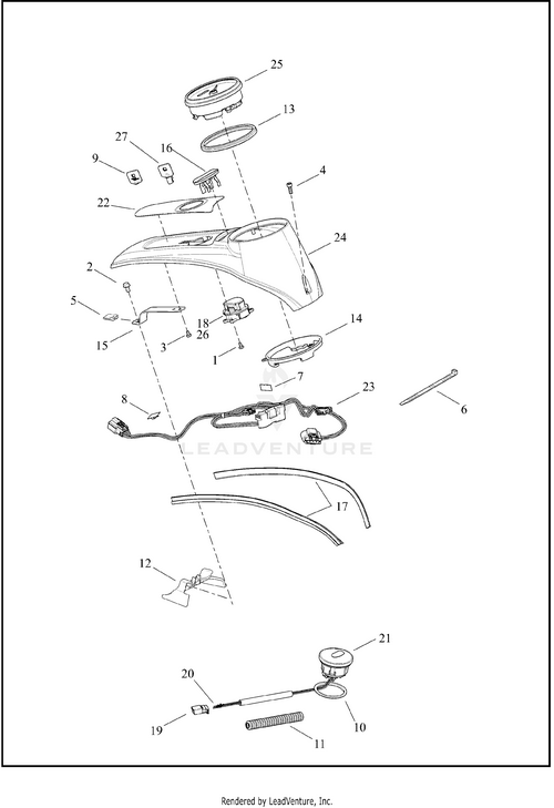

Hello everyone. I decided to powder coat some parts on the 2019 fw and the tank bezel was one of them. Have it all back together and the neutral light stays on all the time and there's no display on the Speedo. All the wires are connected correctly. I did forget to pull the fuse when I started. Could it be a issue with that?

Recheck your work and see if you have a bent connector pin in the harness you took apart

Here is your set up, can u tell what all got removed?
