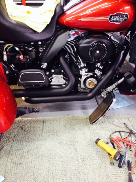

I got my Vance and Hines Classic Turndowns installed. I bought these off eBay and was disappointed when I saw they where covered in surface rust. I sanded the bodies down and painted them with high temp black paint. I was able to polish the chrome tips. They look pretty good. I can't wait to hear how they sound.

The seller described them as "slight discoloration from heat". I pulled them out and my wife saw they were rusty right away. I liked the look after I got them sanded, looked like a satin stainless. I didn't think they would hold up though if I just clearcoated them. Ive tried to post pictures, but they won't upload for some reason. I'm guessing they are too big.
