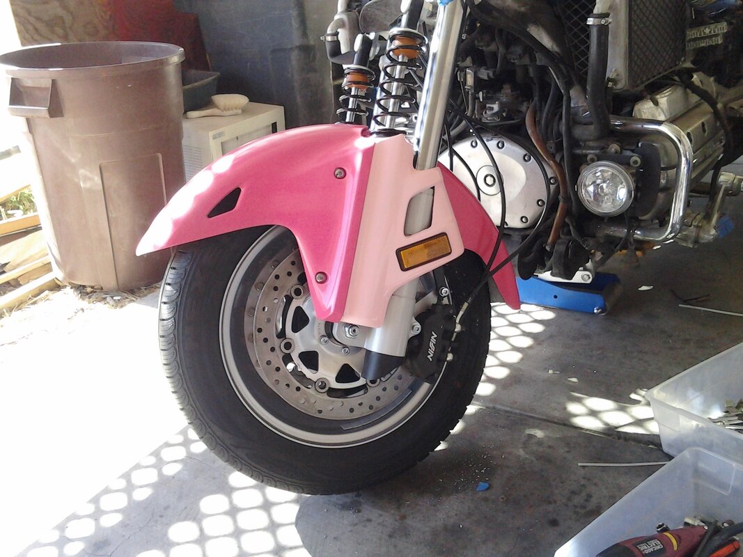

the front fenders, calipers and brake lines tucked in is finished, hopeing to get help tomorrow to finish the brake line connections and replace the bad brake line parts.0209181155.jpg

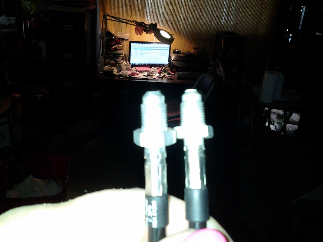

good news, i was right about the over tightened brake lines, the lines and the connecting parts were badly damaged. all fixed now, the rear lines are mounted and tight. the front lines mounting hole needs a heli coil. but they are all routed and connected just 1 hole to fix and its time to bleed.0210181414.jpg0210181639.jpg

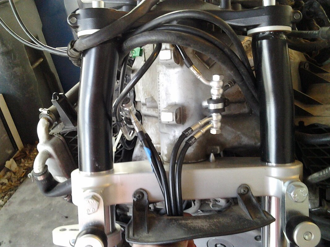

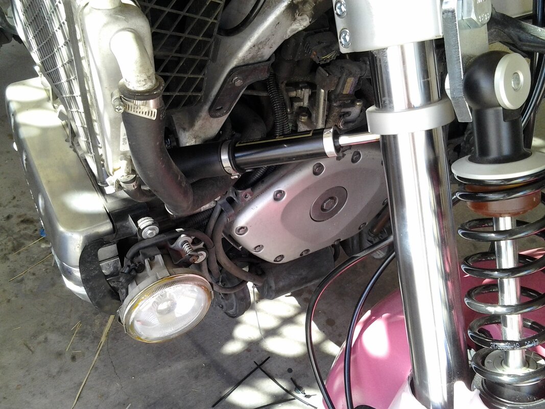

all the mechanical assembly is finished. all the brake lines are routed and connected tight. all other cables lines and hoses on the neck are routed and secured. the steering stabalizer is installed and functions properly. now i can bleed we just ran out of steam and time today. but we are ready. :clapping:
I did not like routing the front brake line through the handle bars to much kinking, it is very comfortable with the throttle cables does not kink, rub or twist or bend now.:clapping:

I am so glad I was right about my friend over tightening the brake lines. the new ones tightened properly are not leaking.:clapping:

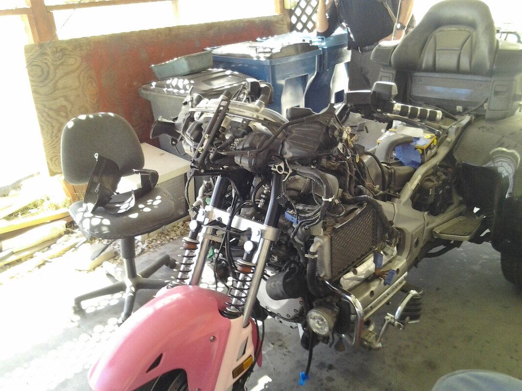

I did get the radiators on and filled. I got the main stay on and I can connect the wiring myself I hope. the body I have to have help with, so im on hold again. here is a pic of how far I got before I caught him stealing from me.:gah::xzqxz::mad:
