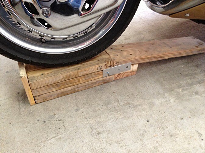

If you do not have access to a lift table and have moderate woodworking skills you can build a set of ramps like mine. They raise all three wheels 4.5 inches so you can get to some things and also get a floor jack under to do serious lifting. Here is a photo. Use 2X6 for front wheel and 2X10 for rear wheels. Strap holds two halves together for getting the trike on and slotted on the front screw so the ramp portion is removable and out of the way while you roll around. :)
Thanks for the photos I'm going to build something similar. How much trouble is it to drive the trike onto the ramps?
Bill
No problem getting onto the ramp at all. As I recall the flat area is about 14" and the actual ramps are 24 inches. If you make the ramp longer it will be even easier to go up. Be sure to put the stop board on the front. Keeps me from rolling off forward! :xszpv::xszpv:
